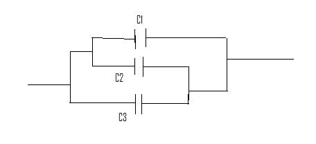

This isn't really a homework question but I figured this would be the best place to post it. Say I had three capacitors like this picture below, I need to combine them into one equivalent capacitor.
none
I BELIEVE that C1 and C2 are in parallel, and then after I add those together, I can solve for that one and C3 in parallel... but I'm not 100% sure. Any help appreciated!
It's obvious how the caps are connected if you redraw the schematic so that all the terminals which are eventually connected to the same line (i.e., at equipotential) go to a single point.
oh! so all 3 are parallel then. right?
Bingo.
