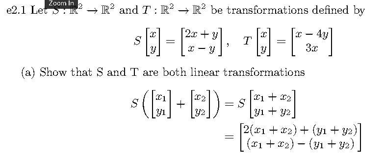

ok this is a clip from my overleaf homework reviewing
just seeing if I am going in the right direction with this
their was an example to follow but it also was a very different problem
much mahalo

The last two lines have two equalities. Their status is not clear. Please say for each equality if it is something you plan to prove, something you assume, or something you have proved and how (by definition, by laws of algebra, etc.).
The claim that $S$ is a linear transformation requires a proof, and a proof is not simply some collection of formulas. A proof is an argument that starts with assumptions and arrives and the desires conclusion. proofs are best expressed using text in a natural language (English) written in complete grammatical sentences.

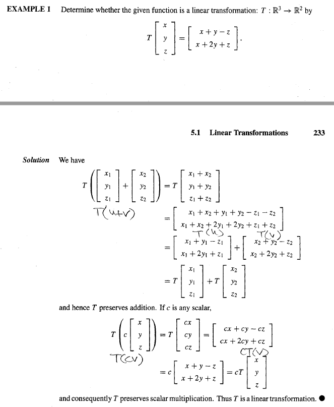

ok here is the example I am trying to follow

Yes, so far what you wrote is correct, and it follows the example.
