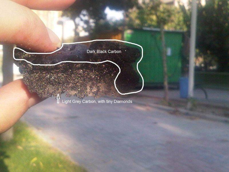

The synthesis of the grapheme foam is a one-step process from room temperature to 1350C with a temperature step of about 5C/min.
It is important that it is performed in a inert atmosphere. A tube furnace is generally used for these purposes.
However, the heating element, tube material and thermocouple will limit the maximum temperature that you can go up to. Due to these limitations, I was only able to go up to 1000C. Below is the sample.
I'd suggest that you would take a look at Dr Wang's recent papers. He has further optimized and examined the bubbling process. Of particular interest is his paper titled "High-throughput fabrication of strutted graphene by ammonium-assisted chemical blowing for high-performance supercapacitors". Study the section titled "Growth process of ammonium-assisted chemical blowing for SG". It will give you a greater insight into the process.
