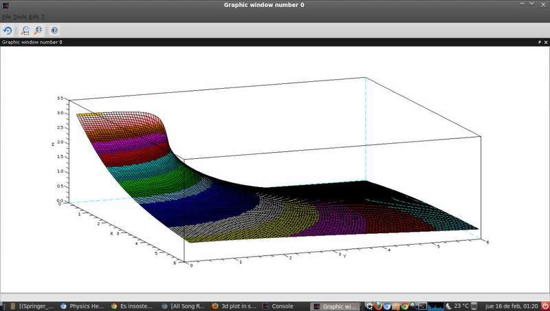

I just downloaded scilab because Wolfram Alpha wouldn't want to plot the function I'd like.
In a physics problem I've found the temperature distribution of a 2 dimensional system. I'd like to visualize this function in 3d.
The function I want to plot is [itex]u(x,y)=\frac{1}{\pi} \arctan \left ( \frac{y+a}{x} \right )+\frac{1}{\pi} \arctan \left ( \frac{a-y}{x} \right )[/itex]. I've read the help file of scilab of how to plot but I'm getting lost very quickly. Any help is appreciated!
Edit: so far I have
Code:
x=[0:0.1:12]'; y=[0:0.1:12]'; z=atan((y-2)/x)+atan((2-y)/2); plot3d(x,y,z)
. I don't know how to pass a line (enter just evaluates the command I wrote). I get the message "Inconsistent addition."

I tried:
Code:
-->x=[0:0.1:12]';
-->y=[0:0.1:12]';
-->z=atan((y-2)/x)+atan((2-y)/x);
-->plot3d(x,y,z)
I do get a 3d surface but it's all flat.

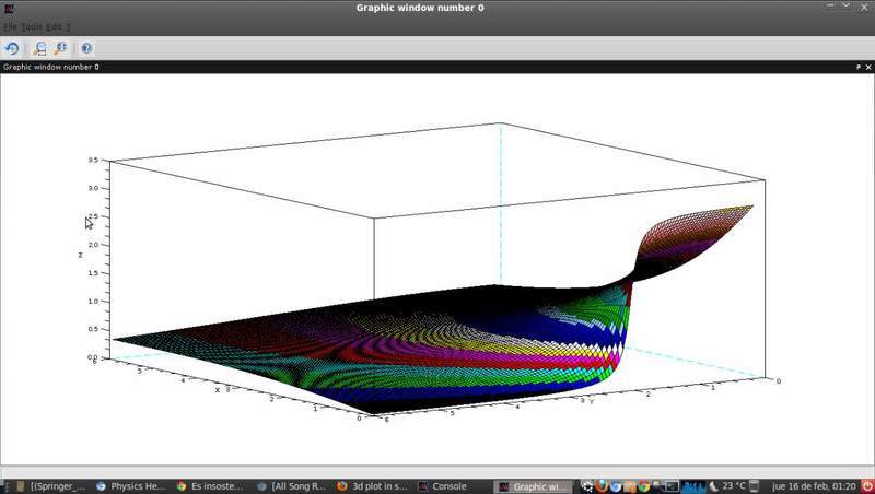

I do:
Code:
-->x = 1:0.1:12;
-->y = 1:0.1:12;
-->[X,Y] = meshgrid(x,y);
-->for i=1:size(X,1)
-->  for j=1:size(X,2)
-->    Z(i,j) = atan((Y(i,j)-2)/X(i,j))+atan((2-Y(i,j))/X(i,j));
-->  end
-->end
-->surf(X,Y,Z)
And I still get a totally planar surface.

Whoops you're right. Well since I took a=2 while it's totally arbitrary, I don't think the 1/pi factor is really relevant.
Using the meshgrid I get a somehow decent surface, but doesn't work well for the plot3d command so far.
Here are 2 screenshots.

gsal said:
Hhhmm...here it is what it looks like with python and matplotlib.
Maybe it's the same. If you take a=2, I suggest you to reduce the box up to y and x=6 rather than 12.
