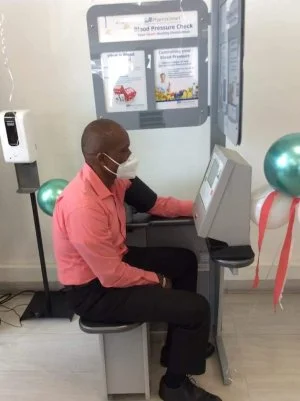

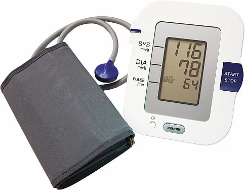

When my blood pressure is measure by ear, a reasonable value is determined. But 4 different automated models produce the same readings that are more than 30 points too high. Why?
The topic is a mix of physics, fluid mechanics, and medicine.
At work, they have a couple of blood pressure kiosks - that look something like this:
Up till about a year ago, I was using something that I got at a local Walgreen's drug store - it looked something like this:
Finally, my wife has a wrist unit and the local Fire department brought their unit over and described it as "the most expensive automated blood pressure cuff you could find". I have tried all four of these and compared them side-by-side with either what a clinician at my doctors office or an experienced advanced life support paramedic determined by listening.
Consistently, BP values in the range of 150 (as determined by the clinician or ALS paramedic) are being read by these automated machines as over 180 to 190.

Here's the sequence:
About a year ago, there were questions about the efficacy of my BP medication dose. I wanted to eliminate my home BP cuff as an issue, so I took it along to a doctors visit. While there, we tested the machine a few times and the clinician took my BP once - but carefully because she knew it would be compared to the machine. My cuff consistently showed a BP reading 30+ points higher than hers, so we concluded that my cuff was bad and I threw it out.
On Monday, while I was coming out of the fitness center, I noticed that my current work location has a BP kiosk. So, I checked my BP and it was alarmingly high. But I recalled that measurements take a year ago at a similar kiosk at my old work location was also giving me high readings - readings that I had taken as accurate.
Yesterday, on the way into the fitness center, I checked my BP at the kiosk again. It was about 185/105. I rechecked several times - one reading came it at 175/100 but all the other readings were about 185/100.
When I got home yesterday, I used my wife's automated wrist cuff and got 183/105.
So, I called the local fire department and they came over for a visit. I explained the situation, so their most able ALS paramedic took a very careful reading 150/90. They then offered to take it with their machine. Since I was talking about buying a new one myself, they described theirs as "the most expensive model you can find". They took two readings - about 190/100 and 200/100.
The paramedic then said that he had listened very carefully and there was no audible beat at all once the cuff pressure had reached 150.
