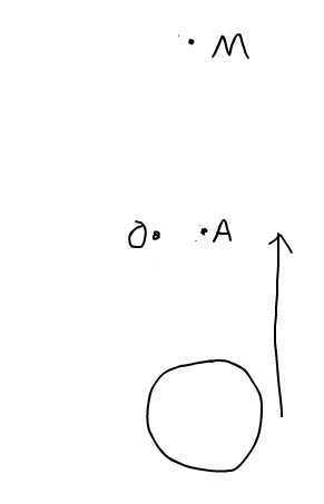

I figured it out! Suppose we have an observer at infinity M, an observer A at co-ordinates (t,r) in M's frame and A pitches an object O at a 3-velocity u radially downwards as shown (file at bottom inconveniently).
In the frame of A the velocity of u is the distance radially traveled divided by the time taken so \overrightarrow{u} = \frac{ds_{A}}{dt_{A}} = \frac{\sqrt{g_{11}}dr_{M}}{dt_{A}} relating to the radial distance traveled in frame M.
Now since x_{M}^{\mu} = (t,r) we get the 4 velocity of O as u_{M}^{\mu}=\frac{dx_{M}^{\mu}}{d\tau} = \frac{dx_{M}^{\mu}}{dt_{A}} \frac{dt_{A}}{d\tau}= \frac{dx_{M}^{\mu}}{dt_{A}}\gamma_{u}
EDIT: d\tau = dt_{O}, proper time is considered in the moving frame O we are interested in.
As A and O are moving at u relative to each other locally. Now we tackle the other fraction:
\frac{dx_{M}^{\mu}}{dt_{A}}\gamma_{u} = \gamma_{u}(\frac{dt_{M}}{dt_{A}}, \frac{dr_{M}}{dt_{A}})
Now we just replace the components with what we already have from the metric and u:
u^{\mu} = \gamma_{u}(\frac{1}{\sqrt{g_{00}}}, \frac{u}{\sqrt{g_{11}}})
Giving us our answer after a lot of Latex experience. As with everything in GR I needed to be more careful with which frame was differentiating which quantity etc. You can easily check the above expression is normalised to unity.

I think your answer is wrong. ##\frac{dt_A}{dτ} ≠ \gamma _u## because O is going deeper into the gravitational potential well. This is not a simple case of applying the principle of equivalence and saying that "we can use SR because A is moving away from O with constant proper acceleration and O is not undergoing any proper acceleration", because O is moving radially, so gravitational time dilation will come into play. I really think you should use the geodesic equation.
Gravitational time dilation is already taken account of due to the 1/√g00 in the 4-velocity.

Yes, all I wanted was the 4 velocity of a particle relative to a distance observer that is thrown by a stationary observer at A with velocity u. I know it's a pretty useless expression in terms of particle dynamics afterwards but I was just curious :)

No it isn't. You need to understand that the metric tensor has different components in different frames. In your OP, you're only talking about O's frame. In #5, you introduced a new intermediate frame A, and just carried over the metric tensor components. It doesn't work that way.
To make it more explicit, I'll write out the whole equation. Let's take the OP first. Let ##x_o## denote O's coordinates. Then ##dt_o^2=(1−\frac{2GM}{r^2} )dt^2−(1−\frac{2GM}{r^2})^{−1} dr^2##. There is no way you can find an expression for ##\frac{dt}{dt_0}## in terms of ##G##, ##M## and ##r## just using this information (you must use the geodesic equation).
Let's talk about #5 now. You haven't clearly defined what A's frame really is, but I'm guessing it "hovers" at constant altitude and it was the point from which O was released with some 3 velocity ##u## in the radial direction (towards ##M## ). Let ##x_A## denote A′s coordinates. So we have ##dt_A^2 = (1- \frac{2GM}{r_A^2}) dt^2##, where ##r_A## is the constant altitude at which A hovers. But we want to convert to O′s coordinates, and in A′s frame of reference, O is not stationary, so we get ##dt_o^2=(1−\frac{2GM}{r^2} ) (1- \frac{2GM}{r_A^2})^{-1} dt_A^2−(1−\frac{2GM}{r^2})^{−1} dr^2##. This is as unsolvable as the first scenario (unless you meant something else in your posts).
There is no real need to complicate the problem. Just stick with the OP. I'll help you get started with the geodesic equation:
Take the "far away" coordinates. The metric tensor then has the form ##g_{tt} = (1−\frac{2GM}{r^2} )##, ##g_{rr} = - (1−\frac{2GM}{r^2})^{−1} ##, ##g_{\theta \theta} = 0##, ##g_{\phi \phi} = 0## and ##g_{\mu ν} = 0## for all ##\mu ≠ ν ##. The inverse of the metric, i.e. ##g^{\mu ν}##, will have the components ##g^{tt} = (1−\frac{2GM}{r^2} )^{-1}##, ##g^{rr} = - (1−\frac{2GM}{r^2} )##, and all other components would be zero, as is the case with the 'covariant' version of the metric tensor. (Notice how easy computing the inverse metric components was because the metric tensor was diagonalized in our coordinates.)

I agree that the method that the OP used in post #5, where he tries to express things in O's coordinates and then transform back, is needlessly roundabout. But, since he is only interested in the 4-velocity at one event, the event where O and A are co-located, his method gives the right answer. And since he is only looking for the 4-velocity at one event, there is no need to use the geodesic equation either.
The quick way of getting the right answer is simply to observe that O's 4-velocity is just A's 4-velocity boosted radially inward with ordinary velocity ##u##. So you just take A's 4-velocity, ##u^\mu = (1 / \sqrt{g_{00}}, 0)##, and boost it radially inward with ordinary velocity ##u##. That gives O's 4-velocity as ##u^\mu = \gamma_u (1 / \sqrt{g_{00}}, - u / \sqrt{g_{11}})##; the minus sign in the second component is the only thing missing from post #5. The ##\sqrt{g_{11}}## factor in the second component is needed because we are working in global Schwarzschild coordinates.
If that procedure seems too heuristic, it's easy enough to add a step to make it more rigorous: first, observe that in A's local inertial frame, his 4-velocity is ##(1, 0)##, so O's 4-velocity at the event where they are co-located must be ##\gamma_u (1, - u)## by a standard Lorentz transformation. Then just transform back to global coordinates, which adds the square roots of the metric coefficients in the denominators.
