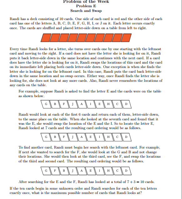

Ilikebugs
94
I don't know where to startView attachment 6552

Hi Ilikebugs. Where do these problems come from?
my teacher puts it in a drive every week
I think to begin, I would imagine that Randi has the cards arranged in the same order she will seek them...for example suppose she will seek them in the order:
A B C D E F G H I J
and this is the order in which they are arranged. How many cards will she have to look at?
Next, imagine she will seek them in the same order as before, but this time they are arranged in the opposite orderr:
J I H G F E D C B A
Then, keeping the same order of seeking, but using at least two random orderings (not including the two orders previously checked), count how many cards she would have to look at. I recommend getting a deck of playing cards to conduct your trials.
What are your findings?
I got 2(2+4+6+8+10)=60
I don't have a proof yet, but I'm convinced that the answer for n cards is n(n+3)/2-1. So for n=10, the answer is 64. If I can come up with a proof, I'll post again. The computer verified the formula for values of n up to and including 10. For n=10, the value 64 is realized for initial
ordering of the cards ABCDEFGHIJ and search order BCDEFGHIJA; you can verify by hand that 64 "probes" are needed. Furthermore, the machine found that this is the only situation requiring 64 probes. This must lead to a proof, but I don't see it.
P.S. At first I thought as you did that the answer for n=10 cards is 60, but the machine convinced me otherwise.

Interesting...I also thought 60 would be the maximum number too. (Thinking)
Here's a sketch for why 64 is the correct answer (procrastinating from studying for my exams...). If we think that the worse case scenario is when the cards are placed in position [1,2,3,4,5,6,7,8,9,10], and we search in the order [10,9,8,7,...], then that would yield 60. But, the true worse case scenario is when we search in the order [2,3,4,5,6,7,8,9,1], where the "first" element in the array is shifted $n$ times to the right, where $n$ is the size of the array. So, for $n$ cards, the answer is $n(n+1)/2-1$ + $n$.
Yes, now it makes sense to me the think of the "worst case scenario" for $n$ cards (let's call this $W_n$) to be:
$$W_n=\sum_{k=2}^{n}(k)+n=\frac{n(n+1)}{2}-1+n=\frac{n^2+3n-2}{2}$$
This avoids the case where the desired card is in the leftmost position, but all other positions 2-10 are utilized and guarantees two occasions where the desired card is in the rightmost position. Basically, we can have all positions where positions 1-10 are realized, and because of swapping, we can replace the smallest (1) with the largest ($n$) to get the maximum, which you and John got with your orderings. (Yes)
edit: Interestingly, it appears that the best cast scenario $B_n$ is:
$$B_n=\sum_{k=1}^{n}(k)=\frac{n(n+1)}{2}$$
And that occurs when the cards are ordered in the seek order. And after all cards have been swapped during the best case trial, they are now in the order for the worst case if the same seek order is used. :D
