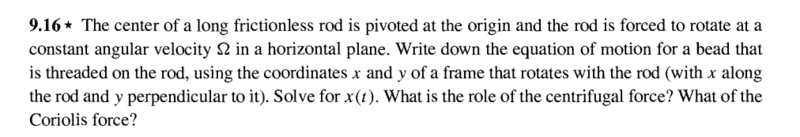

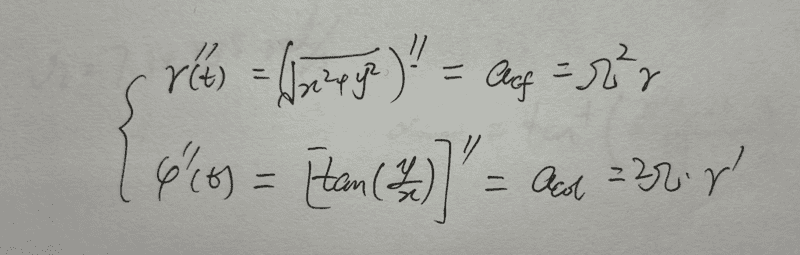

I intuitively think this is a helix, x(t) probably a exponential solved by ODE, but I cannot come up with it.. I think in this problem. Coriolis force is for tangential acceleration(r(t) increases) and the centrifugal force is making r(t) increases.
F_cor=2mv $Omega$
F_cf=$Omega^2$m*r
I came up with these: (especially not sure if second is right)
From eqs 1 I can get r is exponential, question is to get y/x or other relation from eqs 2

The instructions are to use x as the radial distance, etc. Turning those into r, phi and using x, y for fixed axes is not going to help.
Start by considering first derivatives, like ##\dot y##.
