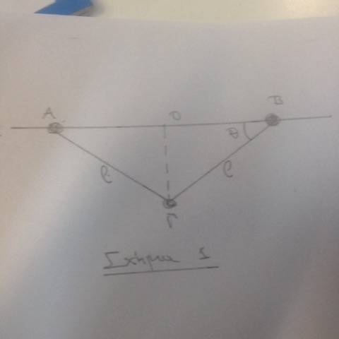

Consider 2 balls A,B on the same line . and they are connected to a third one G with a rope L. AG, AB. now the system monves in the effect of the mass of G and its projection to the line AB is in the middle. No friction. mass of A=mass of B=m and mass of G=2m
.FInd the time of impact and the velocity of G at that time
I know the only forces are From the rope. 2 on the G ball and 1 in each of the balls.I understant i have to apply conservation law of energy but how? What is the potential energy? And also How to calculate the forces. Is it like the 3ball acts like gravity would do?
Hand-drawn diagram of a symmetric system: a horizontal line with points A and B at its ends, and a point O on the line above a point G below, with dashed line from O to G. Strings of length l join A to G and B to G. Angle theta marked at B. Labeled Σχήμα 1 below.
  • Hand-drawn diagram of a symmetric system: a horizontal line with points A and B at its ends, and a point O on the line above a point G below, with dashed line from O to G. Strings of length l join A to G and B to G. Angle theta marked at B. Labeled Σχήμα 1 below.

My understanding of the question is that A and B are constrained to move horizontally, while G descends under gravity.
Please confirm or correct.
yes they are costrained to move horizontally only!

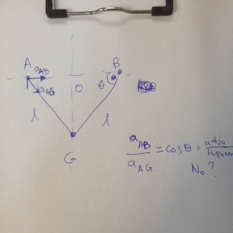

Handwritten diagram on a whiteboard of a pendulum-like setup: pivot point G at the bottom with two strings of length l meeting at it, a point A on the left and B on the right, with angle theta marked. Below is written a_AB / a_AG = cos theta = adjacent/hypotenuse, followed by No?
  • Handwritten diagram on a whiteboard of a pendulum-like setup: pivot point G at the bottom with two strings of length l meeting at it, a point A on the left and B on the right, with angle theta marked. Below is written a_AB / a_AG = cos theta = adjacent/hypotenuse, followed by No?
You are making an assumption about which is adjacent and which is hypotenuse.
If you have any vector - force, acceleration, velocity, whatever - and you want a component of that in some other direction then the vector you started with is the hypotenuse.

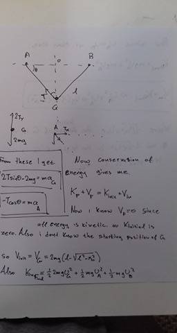

Handwritten physics working: a pendulum-style diagram with points A, B and O, a ball labelled G with mass 2mg, and equations including 2T sinθ - 2mg = mq/a, -T cosθ = ma/l, and energy conservation K_P + V_P = K_final + V_final, with V_P = 0 and V_initial = V_C = 2mg(L - √(L² - h²)).
my progress so far...
  • Handwritten physics working: a pendulum-style diagram with points A, B and O, a ball labelled G with mass 2mg, and equations including 2T sinθ - 2mg = mq/a, -T cosθ = ma/l, and energy conservation K_P + V_P = K_final + V_final, with V_P = 0 and V_initial = V_C = 2mg(L - √(L² - h²)).

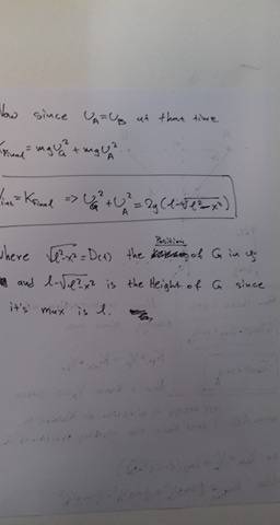

  • Handwritten derivation on lined paper: 'Now since v_A = v_B at this time, K_final = m_B v_B^2 ... + m_A v_A^2', then 'K_initial = K_final => v_A^2 + v_A^2 = 2g(l - sqrt(l^2 - x^2))', with 'sqrt(l^2 - x^2) = D(x)' the distance of G in ..., and 'l - sqrt(l^2 - x^2)' the height of G since its max is l.
Your force equations might be ok... depends which directions you are defining as positive.
As I mentioned, there really is no point in working with energy conservation since you are asked to find time.
Please do not post algebra as images. It makes it hard to comment on specific lines.

Apply what I explained about resolving components in post #18 and hence find the correct relationship between aA and its component in the AG direction.
You will find it valuable to be able to do this correctly. It is fundamental to many kinematics problems.
ok if a_A is the acceleration on x axes then cosθ=a_AG/a_A right? where a_AG is the component in a_AG direction
Yes.
Now consider this: the distance from A to G is constant. What does that tell you about how the component of G's acceleration in the AG direction relates to aAG?
