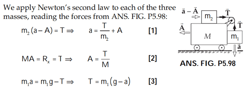

Let me go back and review the proffered solution with which I think you disagree.
So contrary to your assertion ##a## is taken as the vertical acceleration of ##m_1## on the right. Not ##m_2## up top.
##a-A## is then the horizontal acceleration of ##m_2## up on top. Just as you agree it should be. The pulley is accelerating leftward while block ##m_2## is accelerating rightward.
The rate at which the length of horizontal cord is shortening is given by an acceleration rate of ##(a-A) - A = a##. The rate at which the length of vertical cord is lengthening is given by an acceleration rate of ##a##. This consistency check passes!
Note that mass ##m_1## will be remaining horizontally in place while mass ##M## moves away to the left. From the point of view of the accelerating rest frame of ##M##, mass ##m_1## will be swinging horizontally away.
Are we in agreement so far?
If we examine the equations, we have: $$m_2(a-A) = T$$The acceleration term is relative to the ground frame. We have no inertial pseudo forces to account for. The only horizontal force on ##m_2## is T. So that equation is fine.
We also have: $$m_1a = m_1g - T$$That is, the net downward force on ##m_1## is the downward force from gravity plus the upward force from tension. That seems straightforward enough.
What is your objection?

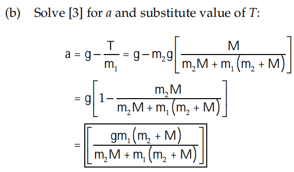

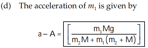

To everything you have stated, I agree. However, my objection does not come from the portion of the solution you have pointed out. Rather, here:

I believe the continued solution here contradicts with the established accelerations in the previous portion of the solution.
What I see here is a formula for (b) that evaluates to ##a## which you have agreed is the acceleration of ##m_1##. However, (b) was supposed to be about the acceleration of ##m_2##.
I suspect that it is a correct answer for (d). Though I have not verified the formula.
What I also see here is a formula for (d) that evaluates to ##a-A## which you have agreed is the acceleration of ##m_2##. However, (d) was supposed to be about the acceleration of ##m_1##.
I suspect that this is a correct answer for (b). Though I have not verified the formula.

That is exactly the crux of my issue. I was able to obtain the same equations in my solution but I was utterly confused why the author seemingly did a switcheroo.
So your concern all along was not with the consistency of the accelerations. Or the correctness of the solutions. It was with labelling.
