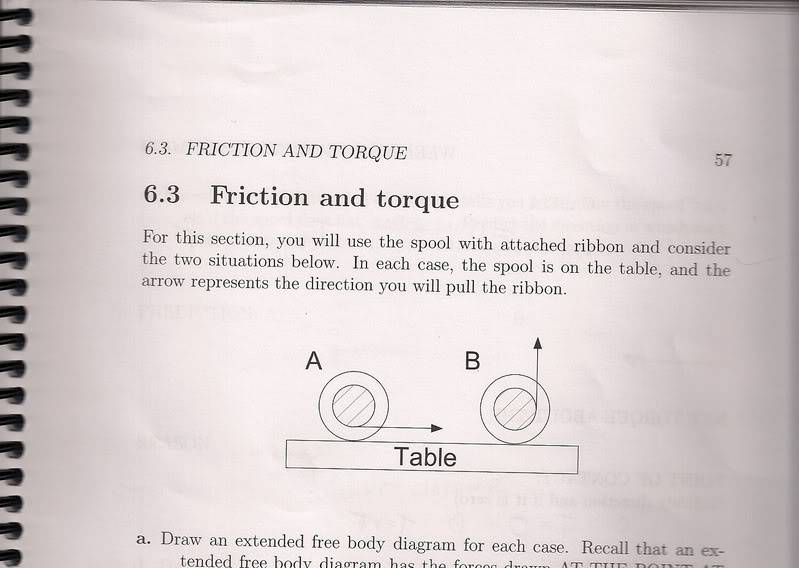

Question 1:
Two diagrams of a spool resting on a table: in case A a horizontal arrow pulls from the spool's top-right edge, and in case B an upward arrow pulls from the spool's right side, both labeled.
I was told here that in Case A, the torque is equal to zero. I'm not really seeing that. I know torque is equal to rFsin[tex]\theta[/tex]. If I draw a vector from the rotation point (the very center of the spool) to the point where the force is being applied, I get that the force and r are perpendicular, so sin[tex]\theta[/tex]=1. Where am I going wrong? I was told that the torque in case B is rF, which I can clearly see by the same reasoning.

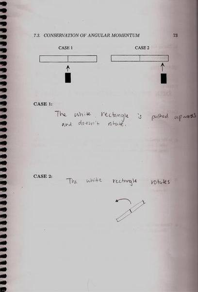

Question 2:
Handwritten notes on a page titled 7.3 Conservation of Angular Momentum: two diagrams labelled Case 1 and Case 2, each a rectangle with an arrow pushing up on a block; Case 1 note says the white rectangle is pushed upwards and doesn't rotate, Case 2 note says the white rectangle rotates, with a curved arrow sketch of a rotating rectangle.
For both cases, I was told the net force and net torque on the system is 0. The system is considered to be both of the objects. If someone could explain this I'd appreciate it.
Thanks.
"net"

Hi haydn! :smile:
(i'm assuming that the friction is preventing the spool from moving)
If the spool isn't moving, then yes the net torque is zero.
The net torque is the sum of the torque from the ribbon and the torque (or moment … same thing :biggrin:) from the friction force (and, technically the torque of the weight also, though if you take torque about the centre, then that will be zero :wink:)
Question 2 is similar … you use the net force or torque, which means adding all the forces or torques. :smile:
Thanks for the reply. I'm not sure I'm understanding your explanation completely. Please tell me if I'm right or wrong here.
For my first question, in case A, the net torque is 0 because the friction force and the force applied via the ribbon cancel each other out. So incorporating the equation t=rFsin[tex]\theta[/tex], you would plug the net force, 0 into the equation?
Then for case B on the second question though, there are two force components, friction and the force applied via the ribbon... wouldn't this result in a net force at some angle other than 90 degrees? I was told thought that for case B, torque is just equal to rF.
Thanks for the help.
I'm really not following what you're doing.
The question quite clearly tells you to start by drawing "an extended free body diagram for each case".
Have you done this? What does it show? What equations can you get from it?
Yes I drew free body diagrams. For case A I have a force going to the right via the ribbon and a friction force going to the left. I believe these cancel out for a net force of 0.
For case B I have a force going straight up via the ribbon and a friction force perpendicular to that, going to the left along the table. I don't get how the net torque in this case is equal to rF.
No you didn't …
what about the other forces?​
