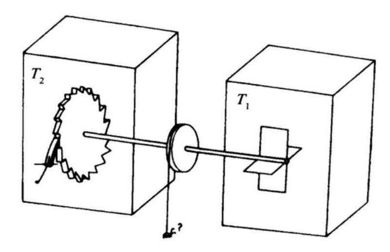

In 1912, Smoluchowski proposed a Brownian ratchet device. In 1962, Feynman conducted its first quantitative analysis. This device consists of two parts: a small paddle immersed in an ideal gas at temperature ##T_1## and a ratchet immersed in an ideal gas at temperature ##T_2##, connected to the paddle by a linkage. A pulley shaft is fixed in the middle of the linkage, with an object suspended below it. The ratchet is asymmetric in shape and has a small spring piece called a pawl that catches on the ratchet teeth. All components of the system are lightweight. Smoluchowski pointed out that when liquid molecules undergo random motion and collide with the paddle wheel, they will set it in motion.
The pawl restricts the ratchet to rotate in only one direction. Therefore, even if ##T_1 = T_2##, the system will continue to rotate in the same direction, thus extracting mechanical work from the internal energy of a thermally equilibrated system, violating the second law of thermodynamics.
1. When ##T_1 = T_2##, how will the system rotate?
(a) Completely stationary
(b) Rotating clockwise
(c) Both clockwise and counterclockwise rotation, with a net clock-
wise rotation on average
(d) Both clockwise and counterclockwise rotation, with no net di-
rection
2. When ##T_1 > T_2##:
(a) Estimate the average angular velocity of the system. Assume that each tooth of the ratchet corresponds to a central angle of ##\theta##. The radius of the pulley shaft in the linkage is
##R##, and the mass of the suspended object is ##m##, with all other components being lightweight.
(b) Determine the energy ##E## transferred from the gas on one side of the small paddle wheel to the small paddle wheel during the rotation of one tooth of the ratchet.

Can you please provide a schematic of the setup?
The problem doesn't mention viscous drag so why did you bring it in? First assume the system is as simple as possible.
Yes. Here it is.

I think you are going to need to include viscous effects to solve this (as you already seem to be doing).
This problem should be framed by the following chapter of "The Feynman Lectures on Physics.": https://www.feynmanlectures.caltech.edu/I_46.html. Could you help me figure out how to solve it based on this newly reported paper? I will be very grateful if any of you could help me out. Thank you.

I see you found Feynman's discussion about it. I think the heart of it is the third paragraph of 46-2 where Feynman introduces his terminology. First see if you can follow how he sets up the problem. As I understand it, he is simplifying the problem to it's core basics and applying thermodynamic probabilities as though each event (such as the ratchet moving through a small angle ##\theta##) were a single particle and not like a macroscopic group of particles.

You are being asked to frame the problem slightly differently that Feynman. You have the angle and radius of the gear which can relate to the height ##h## the mass is raised against gravity. Feynman just calls the energy raising the mass ##\epsilon## which should be the same as ##mgh##.

As I recall Feynman analyzes the effect of hanging a flea on the thread attached to the pulley. So ##m_{flea}##. I believe his solution is that for ##T_1\gt T_2## the machine will rotate according to your analysis but that the pall requires viscosity to keep from bouncing higher and higher with each impact (you do the mechanics of that if you wish) thus heating the fluid in its container until ##T_2=T_1##.

Feynman uses ##L## as torque. You can figure that from the force of gravity, the angle and radius. ##\tau## is an assumed rate. Yes, this is a thermodynamics problem primarily, not just a mechanics problem but the mechanics is consistent with energy expended or generated. As I said and understand Feynman reduces the problem to thinking of individual particle equivalents which is why he uses the fundamental probability ~##e^{-kT}## for each action or event. It is all summarized in Table 46-1.
Viscosity is never free. All "frictional" forces just sweep energy to degrees of freedom we do not look at in detail. What is the "solution" to the problem that you desire ? I described the physics above. The details of the viscosity are very complicated, so I don't understand what a solution is in your mind.

Is it ##L = mgr \sin \theta##? Thanks.
The torque does not depend upon ##\theta## for a string unwinding from an axle
Is it just ##L = mgr##?
