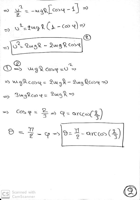

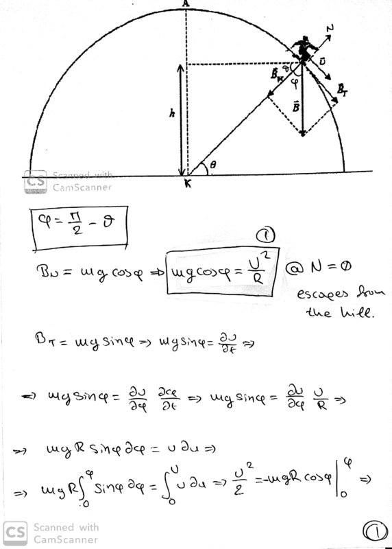

No friction. Initial velocity=0 (pic)
nil
Hi,
This is my try.
Are you in agreement with this ?
Thanks.
I agree.
