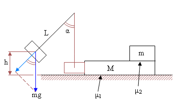

Mass m is raised to height h and released. it hits, elastically, mass M which is on a surface with friction coefficient μ1. mass m, same as the first, lies on top of M. the coefficient between them is μ2.
1) What's the box's velocity just before the hit
2) What is the tension T1 in the rope immediately after releasing
3) What is the tension T2 in the rope just before the hit
4) What is M's acceleration immediately after the hit
5) What is m's acceleration (the box on top) immediately after the hit
6) How much time M travels till it stops
7) Draw on one coordinate system M and m's velocities till they halt, relative to the floor
8) What distance M travels till it halts
9) What should be the minimal length of M so that m won't fall

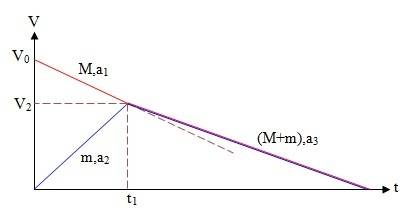

The graph:
to check which line is more inclined, i compare a1 to a3:
$$a_1=\frac{g\left[ (M+m)\mu_1+m\mu_2 \right]}{M}=\left[ \frac{M+m}{M}\mu_1+\frac{m}{M}\mu_2 \right]g>a_3=\mu_1g$$

It would appear from the diagram that you would need to express the height of the mass on the string in terms of alpha.
can someone else have a look?
Your expression for V0 is wrong. It should be much simpler.

Yes, that all looks good except I did not check the part after "but the expressions are still complicated". I assume from there you are answering (9), since you already have the answers for all the other parts. For part (9), you know the initial relative velocity, V0, the final relative velocity, 0, and the relative acceleration, a1+a2. You can get the relative distance straight from those.
