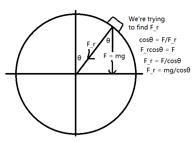

A point mass is placed at the north pole of a ball within a homogeneous vertical gravitational field with acceleration g. The mass therefore resides in an unstable equilibrium
from which it is removed by a negligibly small kick. It then glides without friction down
the surface of the ball. At which angle θ does the mass lift off from the surface of the
ball? Hint: To obtain the velocity of the mass as a function of the angle, you can use conservation
of energy. Alternatively, you can multiply the equation of motion for θ(t) by ##\dot{\theta}## and
integrate over time.

Now for the constraint condition: F_r = F_c. ## F_r = mg/cos\theta ## (once again from diagram) and ## F_c = \frac{mv^2}{R} ##, the latter of which is also from my textbook so I would really hope it's dimensionally consistent 😀. Also, ##v = R\dot{\theta}##.
$$ \frac{mg}{cos\theta} = \frac{mv^2}{R} \rightarrow \frac{mg}{cos\theta} = \frac{mR^2\dot{\theta}^2}{R} = mR\dot{\theta}^2 \rightarrow \frac{g}{cos\theta} = R\dot{\theta}^2 $$
This is certainly cleaner than whatever I wrote down last time so I'm hoping this actually works out. As for the units, the left side has units of m/s^2 and the right has units of 1/s^2*m. I'm just ignoring the radians because they're dimensionless units and don't affect this analysis.
$$ \frac{g}{cos\theta} = R\frac{2g - 2gcos\theta}{R} \rightarrow cos\theta = 2 - 2cos\theta $$
$$ 1 = \frac{2}{cos\theta} - 2 \rightarrow 3 = \frac{2}{cos\theta} \rightarrow cos\theta = \frac{2}{3} $$
$$ \theta = arccos\frac{2}{3} $$
And even the units check out, so, I guess I solved it? If there are still any errors do point them out but I actually think I did get everything this time. Thanks for the help folks!

You have not specified the generalized coordinates in a diagram. In my opinion, that is a must when you use Lagrangians. Furthermore, you have been rather cavalier with the constraint that the mass stay on the sphere. This is how I would do it.
Define Cartesian coordinates ##x## and ##y## with the origin at the center of the sphere. Then
##T=\frac{1}{2}m\left(\dot x^2+\dot y^2\right)##
The constraints are ##x=R\sin\theta~\implies \dot x=R~\dot {\theta}\cos\theta##
##y=R\cos\theta~\implies \dot y=-R~\dot {\theta}\sin\theta##

giraffe714 said:
f I'm understanding this correctly, the constraints represent the angle θ when the mass slips off, correct?
Incorrect. It is a generalized coordinate (as shown in the picture that you posted) that replaces ##x## and ##y## subject to the constraint that the mass stay on the sphere. The angle at which the mass slips off is a specific value of ##\theta## that you are asked to find. After you rewrite the Lagrangian in terms of ##\theta## and ##\dot{\theta}##, you get the equation of motion from $$\frac{d}{dt}\left(\frac{\partial \mathcal L}{\partial \dot {\theta}}\right)-\frac{\partial \mathcal L}{\partial {\theta}}=0.$$I strongly second @PeroK 's suggestion
