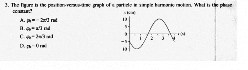

littlejon
v(x)t= -wAsin(w+o)
-5(10)sin(0)= 0
D
is this the right procedure?
littlejon said:
v(x)t= -wAsin(w+o)
I'm not aware of any such equation. The equation you want is of the form x(t) = .
No.
The first step is to figure out the amplitude. Can you think how to read that off the graph?
amplitude is 5
littlejon said:
amplitude is 5
No. How did you arrive at that? How is the amplitude of an oscillation defined?
Have you found a correct equation?
I just saw the wavelength and assumed it was 5.
littlejon said:
v(x)t= -wAsin(w+o)
This equation is wrong.
Amplitude is not wavelength. What do you think is meant by the amplitude of a wave?
You still haven't provided any correct equations related to SHM. Don't you have any notes or textbooks? If not, read it up online.
