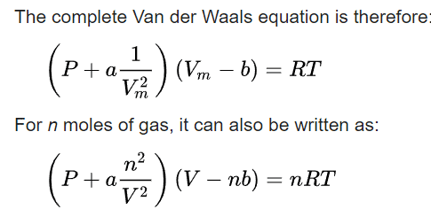

It seems, reading Wikipedia, that perhaps the equation given in this problem is the intensive version. That is, ##v=\frac{V}{n}##.
Indeed, I have not been paying attention to whether ##v## or ##V## is being used.
Not if it says ##PV = RT## for 1 mol (when a and b values are zero )

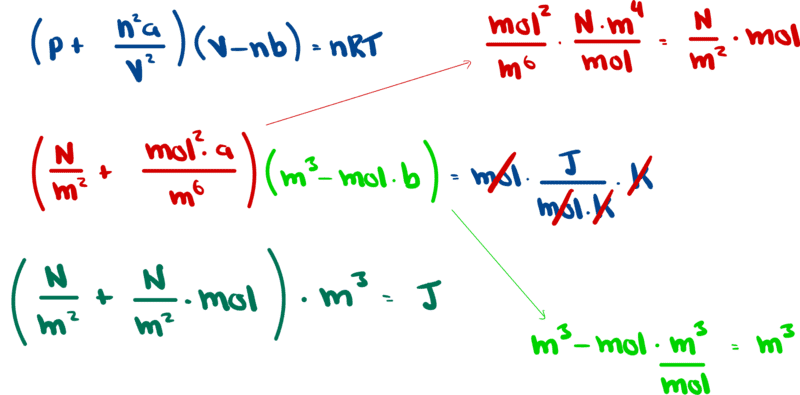

After redoing some calculations, it still seems like the units for ##a## given in the problem are missing a unit of mol in the denominator.
That is, it seems the units for ##a## should be ##\frac{N\cdot m^4}{mol^2}##.
A quick google search seems to indicate this as well.

(b) If ##a=1.4\times 10^9\mathrm{N\cdot m^4/mol}##
I cannot make that work. Should it be ##\mathrm{N\cdot m^4/mol^2}## ?
Yes, those are the correct units for "a".
