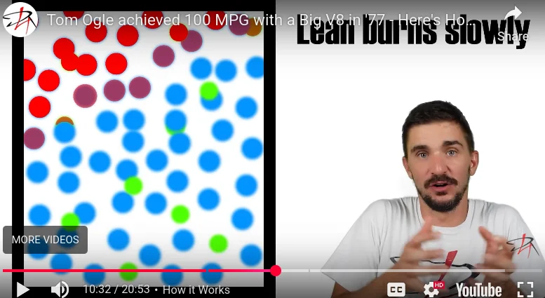

For an automobile ICE, could gasoline be vaporized with a hot plate in a small chamber just before the intake valve to improve mpg at cruising speeds?
Here's a video by “driving 4 answers” who seems to me to be well versed on the details of Internal Combustion engines. The video does cover something that's a bit shrouded in 'conspiracy theory', and he touches on that, but of course for phys.org, I'm only interested in the actual science involved.
He analyzes the claim of achieving 100 mpg with a 427 cubic inch V8 1970 Ford Galaxy in 1977. Only the fuel supply system was modified. I was surprised that he feels the claim could have been realized. The car appears to vaporize the fuel (versus atomizing in a conventional carburetor or fuel injector). He claims a fully vaporized fuel is homogeneous, which burns faster and cleaner with no pockets of lean/rich, and can theoretically run lean, 40:1 ( versus a conventional ~ 22:1 limit ?). He doesn't mention, but I assume there is much lower throttle pumping loss for better mpg.
While he acknowledges it could be done, he says one drawback is very poor performance. I think because vaporized fuel takes up a large volume, so you can only get a relatively small amount of fuel in a cylinder, so limited power. And I think that is why a large V8 was used. That also makes sense from a Brake-Specific Fuel Consumption (BSFC) viewpoint - that big V8 running near open throttle and near full load (at reduced horsepower) would put the engine at an efficient part of the curve. Of course, you can get high mpg by trading acceleration and using a small conventional engine, but you wouldn't get the claimed advantages of fuel vaporization.
OK, so acceleration would be unacceptable. He goes on to say this could be addressed by using fuel injection to accelerate and start the engine, but he seems to poo-poo this as being too complex, and fuel vapors are unsafe. But I think he overstates this. Could there be a pre-combustion chamber on each cylinder, maybe the same volume of the cylinder, or somewhat larger, to hold a supply of vaporized fuel? I could envision a hot plate in that chamber (before the intake valve), and a fuel injector spraying a fine mist onto the hot plate to vaporize that fuel. It would supply just enough fuel for cruising power, the rest of the fuel for acceleration would be supplied by a separate injector that would not cool the plate. The fuel would have time to vaporize as it would be a continuous process. For a pre-combustion chamber the same size as the cylinder, assume 1800 RPM at cruise, at 2 revs per combustion, so 1800/60 = 30 revs/second, so ~ 1/15th of a second (67 ms) to vaporize the fuel. And at 100 mpg and 60 mph ( 1 mile-per-minute), that's 1/100th of a gallon per minute (let's switch to metric at this point!) or ~ 38 ml, divide by 4 cylinders, round to 10 ml, divide by 60 for 0.167 ml/second. I assume that would be do-able, but don't really know. I don't see where this would be a big safety issue, or overly complex.
A pre-combustion chamber would also address the issue he raises that not all components of the fuel vaporize at the same temperature. He claims these components would build up, and have to be drained collected - which would be impractical. But with the pre-combustion chamber, anything not fully vaporized would just be drawn into the engine in atomized form. I don't see a problem here. He seems to be envisioning a large chamber of vaporized fuel supplying all cylinders.
But, it seems we would still need a large displacement engine to get enough horsepower even for cruising speeds due to the volume of the vaporized fuel. That would be a major disadvantage. As I understand, 0.5 L per cylinder is a sort of practical limit for passenger cars engines, and moving to a V8 would be impractical in cost and size for most cars today. Would a supercharger be able to compensate for this, forcing more air/fuel into the cylinder, so maybe a 4 cylinder or V6 could work? Pollution control is another whole story.
Also, for reference, vaporization was used in some early stationary engines (“surface plate carburetor), so it's far from a new idea. But I also wonder, wouldn't running from propane or methane provide similar benefits as attributed to vaporizing gasoline? It's vapor already, right? And flex -fuel engines exist, but I never heard that they run higher efficiency on vapor?
This is really just a mental exercise / thought experiment. But that video made me very curious. Thoughts?

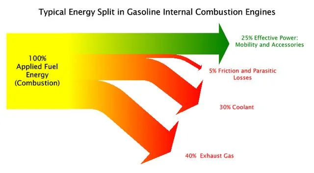

The inefficiencies of internal combustion engines are limited to the four and two stroke cycles - four stokes in a perfect world would be 25% maximum efficiency (100%/4) ...
I'm not following this. You are simply dividing the energy content of the fuel by 4, because the power stroke is 1 of 4? Seems conventional engines are achieving 25% or better. Under this entry in wikipedia, for Otto Cycle engines, https://en.wikipedia.org/wiki/Thermal_efficiency#Engine_cycle_efficiency
Modern engines have compression ratios in the range 8 to 11, resulting in ideal cycle efficiencies of 56% to 61%
A rule of thumb is that a typical normally aspirated automobile gas engine burns 0.5 lbs of gasoline per horsepower-hour. Since gasoline has a heat content of 20,000 BTU per pound, and one horsepower is 2545 BTUH, that is an efficiency of 25.5%. Modern engines are more efficient. From Wikipedia, which lists this page as the source: https://web.archive.org/web/20061010095104/http://www.epa.gov/otaq/models/ngm/may04/crc0304c.pdf: Engines in large diesel trucks, buses, and newer diesel cars can achieve peak efficiencies around 45%.
This thread, in Post #2, has some real world drag and gas mileage data: https://ecomodder.com/forum/showthread.php/coastdown-test-06-gmc-canyon-20405.html. The actual gas mileage matches the mileage calculated from the measured drag when the engine efficiency is assumed to be 0.5 lbs per hp-hour.
My current truck does a lot better. Highway mileage at 55 MPH in the summer is typically 47 MPG, primarily due to the high efficiency of the engine.
One stroke creates power - the other three do not... they eat power output.
Mechanical power out at the crankshaft = Power out combustion stroke - everything else (friction, heat, fluid restrictions, and a bunch of other stuff)
Power at the wheel = Shaft power - all kinds of friction and heat.

One of my favorite engine is a Hit-and-Miss engine which is a regular 4-stroke engine with the throttle constantly wide open, and the speed is govern by allowing fuel to go in the power stroke only when required. So they can go on for dozens of strokes without using any fuel, then when the speed drops, you hear one power stroke. Following, is a video that explains well how they work. They are so simple and slow that you can see every stroke and hear every power stroke.
These engine are not less efficient because they have so many "dead" strokes. If you put more fuel, the engine will accelerate. If you add a load on the crankshaft, it will slow it down and more power strokes will be effective until you have a traditional 4-stroke engine, running at wide-open throttle.
When we talk about engine efficiency, we are talking about, first, the efficiency of the thermodynamic cycle (Otto, Diesel, Brayton, etc.) to convert the energy content of the fuel to mechanical work, and second, the capacity of burning completely the fuel before it goes in the exhaust, and finally, the amount of friction lost in the mechanism. The intake, compression and exhaust strokes are not losses per say as there is no fuel going in to be lost in the first place.

russ_watters said:
Gasoline has an energy content of 33.41 kWh / gal, or 44.8 hp-hr/gal:
https://en.wikipedia.org/wiki/Gasoline_gallon_equivalent#Gasoline_gallon_equivalent_tables
A simple example is 60 mph at 30 gpm = 2 gal / hr or 89.6 hp-h. If the engine is operating at 25% efficiency, that's 22.4 hp.
Google tells me though that a 1970 Ford Galaxie got about 16mpg.
Adding to this: a Mustang Mach-E gets about 3 mi / kWh, almost exactly equivalent to 100mpg, or 12 hp at 80% efficiency. It's in the ballpark of a fair comparison to a modern ICE sedan, since the efficiency of the ICE engine is probably below 25% when it is producing 10% power, and that doesn't include drivetrain losses (electric cars directly power the wheels whereas gas cars lose maybe another 15% between the engine and wheels).
The Galaxie is going to be much less aerodynamic...
There's not a lot of room to improve on the 100mpg-e for an electric and not a lot of room to improve on the fuel economy of a modern gas powered car either, without compromises. The claim in OP requires something akin to 'you're only burning 20% of your fuel', and that just isn't happening.

In the video I posted, the author does seem to think there is merit to vaporizing the fuel, but dismisses it as too complex, too dangerous, and a performance killer. OK, but could my suggestion of having a pre-combustion chamber (maybe the same size as the cylinder displacement) right before the intake valve, with an injector and hot plate to aid vaporization make it safe? Performance could be maintained by just injecting more fuel for acceleration - that fuel wouldn't get vaporized, but would be no worse than current implementations. But if the vaporized fuel would improve MPG for cruise, it would bring up the average MPG.

Another thing is about the flame propagation speed that he talks about at 10:30 in your video:
The flame front does not travel from one molecule to the next. That is way too slow. The airflow must be turbulent and move much faster than the flame front. The following video shows a technique called the tumble flow:

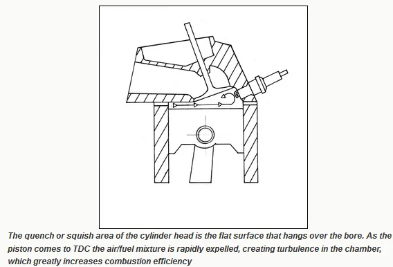

Or the swirl:
Or the quench or squish:
More info: Quench Quest - Squish, Quench, and Piston-to-Head Clearance
I built a 493 CID Chrysler Wedge engine with Quench. I had .060" piston to head clearance. Compression ratio was 11 to 1 running unleaded pump gas. Had cold air intake. Fastest car I ever drove. Estimated 630 HP from similar Stoker 440 cid engine. Cam had .613" lift. Big CID engines love lots of lift. No detonation.
