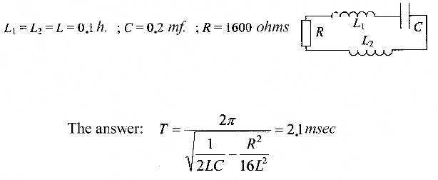

An oscillatory circuit
So, there are parameters of a circuit. Also we got an answer. Just look at image below in the attachments.
This problem uses simple differential equations. All I could write down here is on the wikipedia page: http://en.wikipedia.org/wiki/LC_circuit"
After some pondering, I've got something about that.
[tex]\epsilon=L_{1}\frac{dI}{dt}[/tex]
[tex]\epsilon_{c}=-L_{2}\frac{dI}{dt}[/tex]
[tex]U=I*R[/tex]
[tex]U\epsilon_{c}=\frac{q}{C}[/tex]
So that:
[tex]IR+\frac{q}{c}=\frac{dI}{dt}(L_{1}-L_{2})[/tex]
