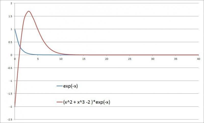

When in doubt, make a drawing:
Of course a logarithmic y-axis mercilessly reveals an ever increasing ratio between the two, but that really doesn't matter.
A bit later on, when you have the steady state solutions, the probabilities to find the particle outside the classical region drop off exponentially, that's the main thing. It doesn't matter all that much (understatement!) whether the actual probability density is 10-44 or 10-38 (your function, x=100 - where classically x ##\approx# 3) .
