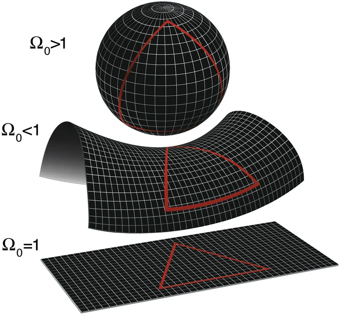

Hello and thank you PAllen.
You reply has touched upon another aspect of singularities that I've been grappling with.
I'm sufficiently au fait with the above diagram to realise that the Open and Flat universes are considered to be infinite in extent, while the Closed one is a finite volume. Therefore, I can appreciate how a pointlike (sorry Ibix) singularity can give birth to such a finite volume. But perhaps you can appreciate my confusion in trying to reconcile how an initial singularity relates to an Open and a Flat universe?
That which is infinite in extent cannot have had a finite point of origin. That's an impossibility. Or so it seems to me.
