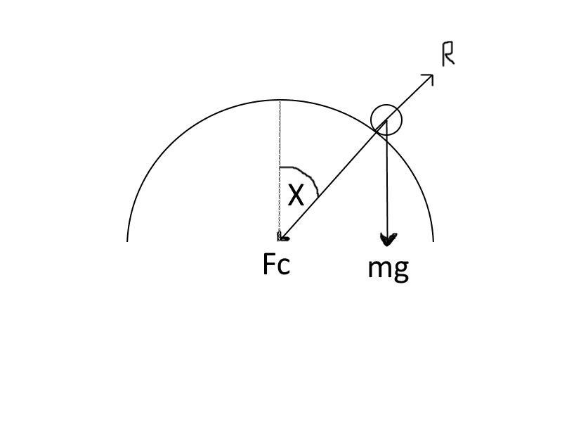

Hi, if you consider a ball, with mass m, rolling down the outer surface of a hemisphere with radius r, why is it that if you consider the forces acting upon the ball and resolve in a direction, the equation formed is:
mgcos(x) - R = m(v^2)/r
If you rearrange that, it would appear that the reaction force is acting in the same direction as the centripetal force and that just doesn't make sense to me. Where am I going wrong here? I'd be grateful if someone could go through this with me :)
Edit: x is the angle between the ball and the vertical line running through the hemisphere's centre
Perhaps start with a drawing and show us how you got that equation.
PS The R term and the 0.5mv^2 term appear to have opposite signs so why do you say they are in same direction?

Free-body diagram of a small object on the inside of a circular track, at angle X from the vertical, with arrows for normal force R pointing outward along the radius, weight mg pointing straight down, and Fc labelled at the centre.
There you go! :)
Consider when X = 90°. Your equation breaks down because the LHS will be zero but yet there should an 'mg' term still acting. Only the normal force from the hemisphere will have gone to zero.

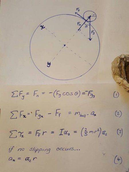

The total forces acting on the ball at any time are
Ftot = Fg + Fn + Ff
Where Ff is the frictional force on the surface of the ball due to contact with the hemisphere. Fg and Fn are gravity and normal, respectively.
Because Fn always acts through the centre of the ball, it induces no torque.
Only Ff will induce a torque to roll the ball, and it follows from Newtons laws in rotational dynamics that for a solid sphere:
Ff*R = 2/5mR^2*alpha.
Where R is the radius of the ball NOT the hemisphere. Alpha is the angular acceleration of the balls surface wrt to its axis of rotation.

Good diagram. Can you explain your confusion? I might write things the other way round:
##R = mg\cos(x) - \frac{mv^2}{r}##
The normal force is what is left after the circular motion takes a bite out of the normal component of the gravitational force. No motion means the sphere feels the full normal gravitational force; and the faster the ball is rolling, the less force is felt by the sphere; until, at some point, the normal force equals zero and the ball comes off the sphere.
Ashton Herbert said:
Free-body diagram of a small circle on the inside of a circular track, with a radial arrow labelled R pointing outward, a downward arrow labelled mg, a dotted vertical line and angle X at the centre labelled Fc.
The arrows indicate the positive direction of the forces. So if R and Fc are both positive, then they point in opposite directions.

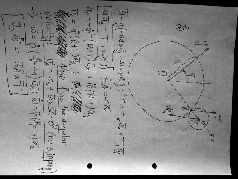

It helps to establish a coordinate system. While you are on the right track with your formula and your diagram, I feel there are essential bits missing from the diagram, and errors in the formula.
There is a *possible* coordinate system drawn below and some relations that might help you to see how you may wish to modify your approach.
Handwritten physics work: a ball rolling inside a circular track with x and y axes, force vectors F_f, F_n, F_g and angle θ, followed by equations (1) to (4) for force and torque balance with no-slip condition.
two vector equations in the brekets give three scalar equations for unknowns ##\dot\varphi, T_x,T_y##
  • Handwritten mechanics derivation rotated 90 degrees: vector equations for acceleration, velocity and angular velocity of a rolling disk, with a sketch of a circle of radius R, centre O, contact point A and axes x, y, z, and a labelled force vector T.

Thanks for the reply! Part of the confusion was caused by me thinking that centripetal force (Fc) was meant to be included in the force diagram. I've read elsewhere that Fc is simply just the "net force" and is equal to (reaction force - mgcos(x)) or (mgcos(x) - reaction force). So the only two forces I needed to draw in that diagram is the reaction force and the weight; I should have mentioned that the hemisphere's surface is smooth so there's no friction involved as well. Thanks again to you and the other people who helped me out here, I appreciate it :)
...if you consider a ball, with mass m, rolling down the outer surface of a hemisphere...
Hi Ashton, you just said there is no friction. So is the ball rolling, or is it sliding?
Generally in this kind of problem 'no friction' would imply no rolling friction, meaning no deformation of the surfaces, and no torque imparted by the normal force.
No friction has implications for the direction of the reaction force in most problems.
