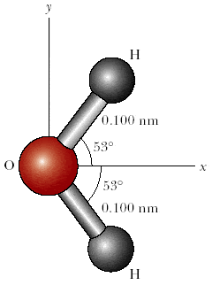

A water molecule consists of an oxygen atom with two hydrogen atoms bound to it as shown in Figure P8.8. The bonds are 0.100 nm in length and the angle between the two bonds is 106°. Use the coordinate axis shown and determine the location of the center of gravity of the molecule. Take the mass of an oxygen atom to be 16 times the mass of hydrogen.
y com = [tex]\Sigma mixi[/tex] / [tex]\Sigma mi[/tex]
Same with x
Let mass of H atom =m, Mass of O atom = 16m
Coordinates of upper H = (0.100cos 53, 0.100 sin 53) (in nm) = (0.06,0.08)
Coordinates of lower H = (0.06,-0.08)
Coorinates of O=(0,0)
x-coordinate of COM = sum of (mass of each particle* its x coordinate ) for each particle , divided by total mass = (1/M)Σmixi
Here total mass M = m+m+16m = 18m
∴xCOM = (m*0.06+m*0.06+0)/18m = 0.12/18 = 0.0067 nm
Similarly , yCOM = ((m*0.08) + m*(-0.08) +0)/18 m = 0 nm
∴ COM of molecule = (0.0067 nm, 0)
But the answer is 0.00669, not 0.0067. And according to me calculator, it is 0.006666667.
Where did 0.0069 came from?
If you want 2 digit accuracy in the answer, you should record
.1*cos(53) as 0.0602
Ah.. I see. ^_^ That tiny bit of omission makes answer different. I was curious because the homework required me to express very accurately. Thanks!
