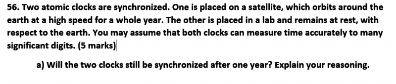

Screenshot of a typed textbook problem 56 about two synchronized atomic clocks, one on an orbiting satellite and one at rest in a lab, asking whether they stay synchronized after one year, with part a) below.

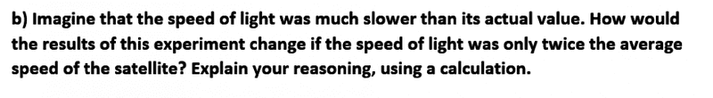

Typed homework question text in bold: b) Imagine that the speed of light was much slower than its actual value. How would the results of this experiment change if the speed of light was only twice the average speed of the satellite? Explain your reasoning, using a calculation.

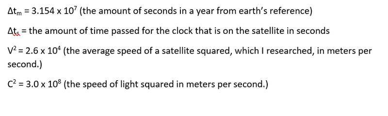

Handwritten-style list defining variables: Δtm = 3.154 x 10^7 seconds in a year (Earth reference); Δts = time elapsed on the satellite clock; V² = 2.6 x 10^4 m²/s²; C² = 3.0 x 10^8 m²/s².

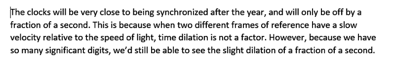

Printed text paragraph stating that clocks will be nearly synchronized after a year, off by only a fraction of a second, since time dilation is negligible at slow relative speeds, though many significant digits could reveal the slight difference.

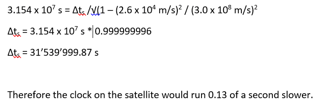

Handwritten-style calculation: 3.154 x 10^7 s = Δt_s / sqrt(1 - (2.6 x 10^4 m/s)^2 / (3.0 x 10^8 m/s)^2), then Δt_s = 3.154 x 10^7 s x 0.999999996, then Δt_s = 31,539,999.87 s, with the conclusion that the satellite clock runs 0.13 of a second slower.

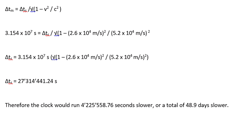

Handwritten-style algebra working in relativistic time dilation: Δtm = Δts / sqrt(1 - v²/c²), substituting 3.154 x 10^7 s, v = 2.6 x 10^4 m/s and c = 5.2 x 10^4 m/s, giving Δts = 27'314'441.24 s, and concluding the clock runs 4'225'558.76 seconds slower, about 48.9 days.
I guess what I'm asking is, am I using the right equation? It's only logical to assume that the Earth's representation of a year's time in seconds would be the Tm and the orbit's representation of a year's time in seconds would be the Ts. Any input?
  • Printed paragraph of text stating that orbiting clocks will be nearly synchronized over a year, off by only a fraction of a second, because time dilation is negligible at low relative speeds, though enough significant digits would reveal the slight difference.

  • Handwritten-style calculation: 3.154 x 10^7 s = Δt_s / sqrt(1 - (2.6 x 10^4 m/s)^2 / (3.0 x 10^8 m/s)^2), then Δt_s = 3.154 x 10^7 s * 0.999999996, then Δt_s = 31'539'999.87 s, followed by the text 'Therefore the clock on the satellite would run 0.13 of a second slower.'

Although arbitrary your satellite velocity looks a bit strange. First, a squared velocity should have units of ##m^2/s^2##, not ##m/s##. Second, I would expect the square of the velocity for an Earth satellite have an order of magnitude closer to ##10^6## or ##10^7## ##m^2/s^2##. Also you stated that the speed of light squared is 3.0 x 108 m/s, which it is not. That's just the speed of light.
Rather than try to work with numbers that are arbitrary anyway, why don't you work with the ratio ##\beta = v/c##? It's a well known convention. Then you can say something like, "Suppose that the satellite's speed in orbit is 1/100,000 c...", and then for the case where the speed of light is presumed to be much lower the value of ##\beta## becomes 1/2.
Using ##\beta## your dilation factor becomes ##\gamma = \frac{1}{\sqrt{1 - \beta^2}}##.
Then you can say that when a year has passed on the Earth bound clock, the satellite borne clock will read only ##year/\gamma##. You can work out how to find the difference in seconds between the readings if you need to.
