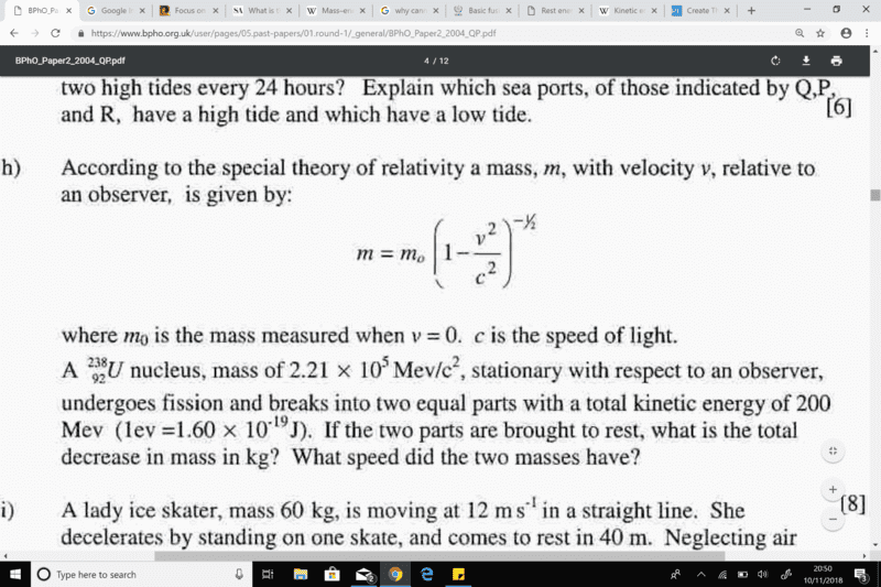

1.
Screenshot of a printed exam page showing the relativistic mass formula m = m0(1 - v^2/c^2)^(-1/2), with a question about uranium-238 fission and a lady ice skater problem.
E=mc^2
Relativistic mass equation given in the question

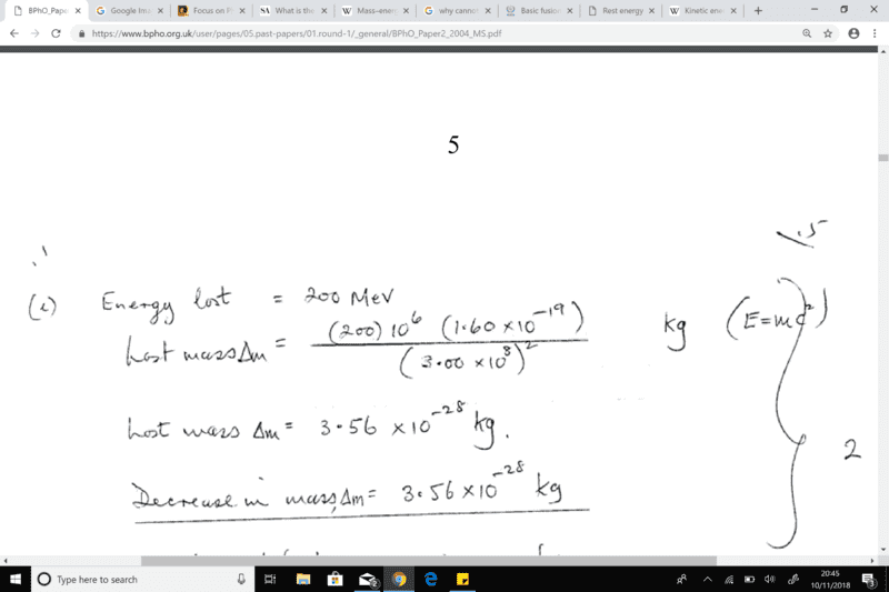

The first part of the question:
I understand 200 MeV is the energy lost as it initially moves with 200MeV however is brought to rest and thus this total kinetic energy must have been transferred from the 'two equal parts'
For the worked solution below,
Handwritten worked solution: Energy lost = 200 MeV; lost mass Δm = (200) 10^6 (1.60 × 10^-19) / (3.00 × 10^8)^2 kg; lost mass Δm = 3.56 × 10^-28 kg; decrease in mass Δm = 3.56 × 10^-28 kg. Annotation (E = mc^2) beside the bracket.
Q : I am confused on how the total energy E=mc^2 = 200 MeV as implied in the work solution.

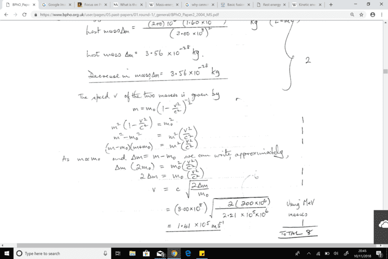

The second Part of the question: What speed did the two masses have?
Handwritten worked solution on lined paper: mass decrease Δm = 3.56 × 10^-28 kg, relativistic mass rearranged to v = c√(2Δm/m0), and final speed v = 1.41 × 10^5 m s^-1.
I see the worked solution rearranges the relativistic mass equation to make v the subject, it does this by using the approximation m = mo as delta m is so small
Q : however I am confused why they plug in 200*10^6 eV for delta m in the 2nd to last line of working shown.
  • Handwritten worked solution: Energy lost = 200 MeV; lost mass Δm = (200) 10^6 (1.60 × 10^-19) / (3.00 × 10^8)^2 kg; lost mass Δm = 3.56 × 10^-28 kg; decrease in mass Δm = 3.56 × 10^-28 kg. Annotation (E = mc^2) beside the bracket.

  • Handwritten worked solution on lined paper: mass decrease Δm = 3.56 × 10^-28 kg, relativistic mass rearranged to v = c√(2Δm/m0), and final speed v = 1.41 × 10^5 m s^-1.

  • Printed exam page showing the relativistic mass formula m = m0(1 - v^2/c^2)^(-1/2) and a question about a uranium-238 nucleus fission with 200 MeV kinetic energy.

If m and mo refer to the relativistic and rest masses of one of the fragments, then Δm would equal ½ ⋅ 200 Mev/c2. But then,
mo ≈ ½ (2.21 x 105 Mev/c2). If you use these values for Δm and mo in the expression
Handwritten equation v = c √(2Δm / m₀), where v is velocity, c is the speed of light, Δm is a mass difference and m₀ is rest mass.
then you can check that this gives the same result as the expression given in the solutions:
Handwritten expression: (3.00 x 10^8) times a square root of 2(200 x 10^6) divided by (2.21 x 10^5 x 10^6), with the 10^6 and 10^5 terms partly unclear.
since the ½ factors cancel.
Note, however, that evaluation does not give
Handwritten expression reading 1.41 x 10^5 MeV/c^2, underlined.
. This is not the correct answer.
