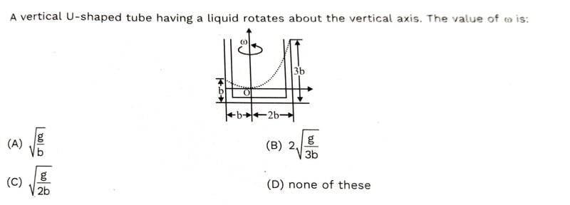

A vertical U tubes having a liquid rotation about the axis as shown. Then the angular velocity is
Force due to liquid column=##V\rho g##
Centripetal force on horizontal liquid =##m\omega^2r##
Area=A
I thought I could use force balance as
$$V\rho g=m\omega^2r$$
But that gives two different values and neither correct
$$(Ab)\rho g=(Ab\rho)\omega^2 (b) \text{ on the left}$$
$$(A×3b)\rho g=(A×2b×\rho)\omega^2(2b) \text{ on the right}$$
Just in case, the answer in the book in B
The water in a horizontal section is not all at the same distance from the axis.
You seem to have assumed pressure at the axis is atmospheric.

So I have to integrate or something?
Isn't the pressure atmospheric everywhere , so it doesn't affect the net results anywhere?
Yes.

So it will be
$$\int{\omega^2r dm}= V\rho g$$
On either side with limits ##0\text{ to }b## and ##0\text{ to }2b## and ##V## changed according to height of liquid column
Aurelius120 said:
So it will be
Better, but you still are not allowing an arbitrary pressure in the water at the axis.

I think I got it
$$\int^b_0{\omega^2 A\rho rdr}-PA=A(b)\rho g$$
$$\int^{2b}_0{\omega^2A\rho rdr}-PA=A(3b)\rho g$$
Therefore
Subtracting equation 1 from 2
$$\frac{3A\rho\omega^2b^2}{2}=2Ab\rho g$$

I am not sure I understand. The water can't be treated as rectangular/cylindrical blocks with forces ##V\rho g## on either side and arbitrary force due pressure in-between❓
Aurelius120 said:
I think I got it
Therefore
Yes, except that the balance is of pressures, not forces. You don’t need A in there. In fact, if the cross-sectional area of the horizontal tube were different from that of the vertical tubes then having those two different areas in your equation would lead to an incorrect result.

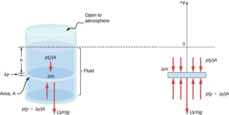

Apologies for not being able to explain myself in a clearer way, as well as for late response.
Those forces acting on the block must be associated with its cross-section areas and with the static pressure acting on each side.
Besides the correct Math solution, did you get a full understanding of the physics behind the different levels reached by the liquid in each branch due to rotation with angular velocity ω?
Please, see:
https://courses.lumenlearning.com/suny-osuniversityphysics/chapter/14-1-fluids-density-and-pressure/
