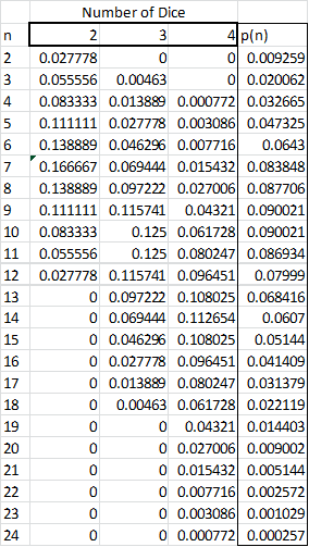

This is a tricky game, so I just hit it with brute force. I am sure there is an elegant answer out there...but here is what I did.
There is a 1/3 chance of having to throw each number of dice (2,3,4). I have built a quick chart to show the probability of any given dice roll (n) given a certain number of dice, with the p(n) being 1/3 times the sum of the 3 probabilities in that row. This shows that your odds of winning can be maximized by choosing the 4 highest probabilities (8.9.10,11)...giving just over 35% chance of winning on the first throw.
Total odds are just over 58% for two throws.

I've tried a bit to find an elegant solution, I didn't succeed, then I didn't have time, but I'm working on it, maybe there is something. My brute force method gave the same results as you, so I guess you found it, yay! :partytime:
