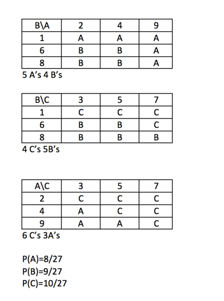

This is what I ended up with when I used tables. I didn't get the same results. C is most common, B second and A last.
Three 3-by-3 tables of die outcomes: B vs A with entries A/B, B\C with entries C/B, A\C with entries C/A, each followed by tallies such as 5 A's 4 B's, 4 C's 5 B's, 6 C's 3 A's, and probabilities P(A)=8/27, P(B)=9/27, P(C)=10/27.

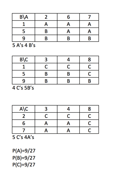

With different data I got the following table. It follows the non transitive property and got me a uniform distribution.
Three 3x3 tables of dice matchups labelled B\A, B\C and A\C, each cell marked A, B or C for the winner, with tallies of 5 A's 4 B's, 4 C's 5 B's and 5 C's 4 A's, and probabilities P(A)=9/27, P(B)=9/27, P(C)=9/27 below.
What are the probabilities you have listed at the bottom? Are they like P(A largest)?
For A ∈ {2,6,7}, B ∈ {1,5,9}, C ∈ {3,4,8}, I get P(A largest) = 8/27. The combinations for that are:
(A, B, C) with A largest = combinations of (A ∈ {6,7}, B ∈ {1,5}, C ∈ {3,4} )

These tables are not correct. You are rolling all 3 dice simultaneously so each element of the table should have the result for each of the three dice. You should never have an entry with just results for A and B but without C because you are rolling all three.

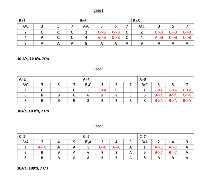

Following your suggestion, I ended up with 3 cases. Two of them are the same as the one you got. When I collapse on B, it's different. So it seems no unique 3x3x3 table exists.
Though there is a weighting towards cases 2 and 3.
So maybe this problem is inherently 4 dimensional? Since there are 3 levels of 3d arrays, producing a unique 4 dimensional table. Of course with extra variables, case1, 2, 3 that needs to be codified somehow. Tangent: this reminds me of quaternions, though I don't know exactly how. This whole situation seems somewhat analogous to rotation in 3space where the order matters.
Three tables labelled Case1, Case2 and Case3, each showing outcome grids for three dice with some entries in red, with totals written below: 7 A's, 10 B's, 10 C's; 10 A's, 10 B's, 7 C's; 10 A's, 10 B's, 7 C's.
In case 1 you mistakenly have 7 winning over 9 in three places. All of your cases are the same thing and give the same result, just written down differently.

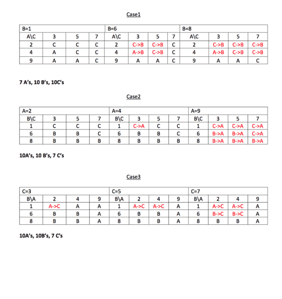

Ok got it. Fixed it. Yes, it makes sense. There is a unique table.
Three tables labelled Case1, Case2 and Case3, each a grid of die-face outcomes marked A, B or C, with red arrows showing swapped winners and totals of 10 A's, 10 B's and 7 C's beneath each.
I guess the non intuitive part is where the first two wins out compared to the third. I'll build the table for a different set of data that satisfies same type of pairwise intransitivity to see if it shifts.
There are 3 tice (3 sided dice) A, B, and C. As @Dale said, rolling all 3 there are 27 equally likely out comes due to uniformity and independence.
In 10 of these A gets the highest roll, in 10 B gets the highest roll, and in 7 C gets the highest roll.
In 15 of these A beats B, in 15 B beats C, and in 15 C beats A.
The table is a 3x3x3 cube.
What is your problem with this?
