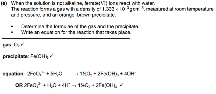

This is the question and the answer, the problem is i don't know how to get to the answer
top is question and bottom is answer
I attempted to divide the gas concentration by 24 to get molar mass, but that didn't work
and how am i suppose to know that OH- is one of the products? i guessed that there is fe(OH)3, but that's all i got right...
it's the very last question from this A level paper
please help, my exams are close, and i have no clue at all...

I see no concentration in the question.
And why do you divide? You have mass of 1 mL, right? Assuming there is one mole of a gas at RTP, what volume does it occupy? What is its mass (given the density as listed)?
It is not that there is OH- between products, however, you won't be able to balance the reaction without either H+ of OH-. That's a quite common situation when it comes to redox reactions in water.
1.3333 × 22 = very close to 32 so that part works well.
