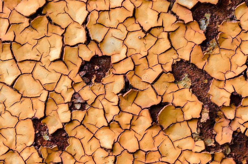

From the picture on the video still, it just looks as if the paint has suffered some premature ageing with flaking and stress cracking.
It could be the paint type and surface are not as compatible as they thought.
Environmental conditions such as variations in humidity or temperature can be the cause. The paint looks as if it has lifted off the surface in part. Perhaps the paint is drying out and not as flexible as when applied.
As well, of course, subsurface defects can be a cause, but the paint is there to protect.
Old paint on houses, cars, farm equipment dulls and ages and cracks from the environment.
Though the paint from the picture does not look as if it has oxidized and become chalky.
This is a picture of OLD paint on sheet metal.
Paint has dried up, shrunk, cracked and let moisture into rust the underlying surface.
