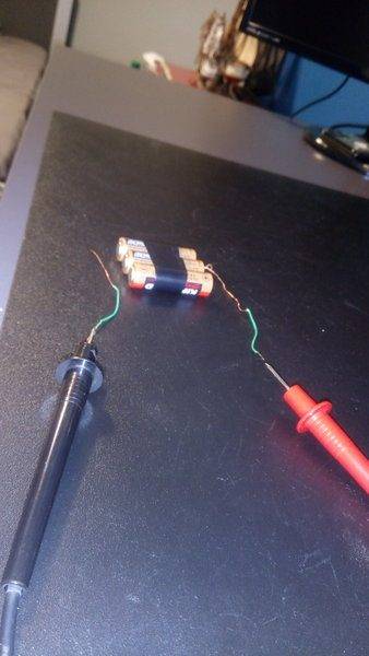

Hey, so I tried to get a lot of Amps and primarly my tool are batteries, so I have 3 batteries that I have connected together in parallel (+ with the + and then - with the -) they are 1.6V Kirkland batteries that are all brand new. So when I took a machine I have to calculate the voltage and amps from a single batter i got 1.6 V which is what was supposed to be and I got 0.3 amps which is I guess normal for a AA battery? However when i connected them with a stripped down telephone wire (copper) and measured the same quantities I was expecting to get 1.6V and 0.9 amps... You know, pretty simple math there... However I got 1.6V and 0.3amps... My batteries are well connected but I keep getting a reading of 0.3 amps... What is happening? P.S the machine I was referring to is a multimeter.
Connected them how? Please show a diagram of all the connections, and the load, and where you make measurements. You can use the UPLOAD button next to POST REPLY and PREVIEW to insert pictures into your post.
Ok so in the pic you can see (could be a bad pic but enough details tbh)

I can't be certain of the circuit you are describing but it doesn't surprise me that the current that your battery or batteries were supplying would have been the battery volts divided by the resistance of the "machine" you were using. (possibly 1.6/0.3 = 5.33Ω) This would be the same for any number of batteries in parallel and it suggests that your batteries are each quite capable of delivering 0.3A without dropping any significant volts.
So I reckon that your Multimeter is the thing that's limiting the current. Its internal resistance makes it unsuitable for doing the measurement that way.
If you want to find how much current your batteries can supply, you need a range of known resistances lower than 5.5Ω and you need to measure the Voltage across the resistor. You can then do I = V/R to find the current that the battery is supplying. I'd imagine that an AA battery could supply up to 2A for a brief time.
What current can you get with two batteries in series? I would think you could expect higher than 0.3A; possibly 0.6A but the internal resistance of the batteries may limit the current to a bit below 0.6A.
PS You should make sure that you cave good contacts around your circuit it's no good just holding meter probes and juggling around with multiple batteries (sorry if that is obvious for you). Also you should take care that components don't get hot with high currents and burn your fingers.

Ah that might be why to be honest... And yes lol I do know about the connections it's because I took it apart not too long ago and I hadn't put it back together so when he asked for the picture I just put them side by side, and in series you'll get the same current but different volts... However looking at the machine I do think there is a cap of current it will measure as there seems to be a 320mA logo but seems to be faded, so quite possibly it does have a cap. Thank you!

Amperage is something you measure in a circuit. You don't have a circuit, you just have a bunch of batteries. Sitting there by themselves, the amperage is zero.
So what you really did is short them with the multi-meter. You are lucky you were only using batteries and weak ones at that, otherwise you would have burned-out or burned the fuse out of your multi-meter.

No no, I do have a circuit, that picture was just the set up of how the batteries were connected...

Right. So measuring amperage is meaningless. A bunch of batteries doesn't have an amperage.

Well it's to build an electromagnet... But I need a lot of amps.

you have a little misunderstanding about current. Current isn't something you supply, it is something that is "drawn" from a PSU ( batteries etc)
and it will depend on the resistance of the load ( circuit) in this case your coil
So measure the resistance of your 20 metres of 22 gauge wire. it may be around 1 Ohm, 2 Ohms at most
After initial experiments ... you should consider increasing that to 2 or 3 times that length and possibly dropping to 26 or 28 gauge
Amps = Volts / Resistance
Amps = 1.6V / 2 Ohms
Amps = 0.8 A
several AA batteries in parallel will handle that current for a short while but as @russ_watters said, they won't last long
