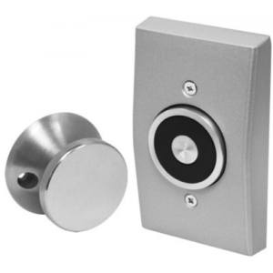

Such a thing is used as an Electric Fire Door Release, use a Google search. The large part, which is an electromagnet, is mounted on the wall behind a door and is powered 12VDC, 24VDC, or 120VAC, drawing around 20mA to 100mA depending on model. The small part is mounted on the door to give the electromagnet something to attract. Different models have a holding power of 20lbs. to over 100lbs.
Fire doors in a building are often left open for convenience. When a Fire Alarm goes off, power is removed from the electromagnet and an ordinary door closer closes the door.
The bullseye pattern is the two magnetic poles of the electromagnet. This design concentrates the magnetic field where you want it, all at one end. The internal construction is similar to the image below (if you don't have that notch cutout) and a coil of wire fills the empty space in this "pot core" shape.
9727e9d160d99ffc550b-e91bafb404d116e05b8f50150b1b07c8.ssl.cf3.rackcdn.com_UK_MIS_PC126_PI_C.jpg
The Physics Forums magnetics specialist is @jim hardy, who may be able to give more details and some design tips.
Hope this helps.

wow that is amazing... thank you so much!

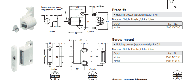

Speaking real simply here,
any magnet has two poles and magnetic flux flows from one pole to the other. It makes a closed loop, just like Kirchhoff's current does.
The two poles of your electromagnet are separated by the length of your nail.
Your magnetic field has to traverse that distance through air.. and air is a terrible conductor of magnetic flux.
Reducing your air gap will give a stronger field. Try bending your nail into a horseshoe shape..
Look at hardware store magnetic door catches. They all have their poles close together for that reason.
https://www.homedecorhardware.com/h...MIkMmV9tvZ2wIVBpNpCh2AbgcDEAQYASABEgLfFPD_BwE
This page addresses permanent magnet gaps, but the principle applies to your electromagnet.
https://www.kjmagnetics.com/blog.asp?p=gap-calculator

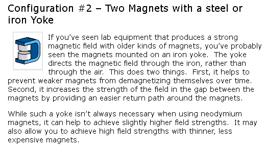

Iron is an excellent conductor of magnetic flux.
That iron yoke let's the flux flow easily around the external part of the magnetic circuit, from top of upper magnet to bottom of lower one. One of those will be a North pole and the other a South.
That way all the magnetic "push" (MMF is what we call it) is acting on the air gap, practically none gets wasted externally.
What clever mechanical construct can you come up with to minimize your air gap and put your flux where you want it ?

Wow that helped even more... Thank you so much! I'm trying to create a sort of 3D design using magnets (there's an actual purpose for this) I am 17 years old and I do a lot to help other people... If I could get this to work I believe it could do a lot... Thanks!
