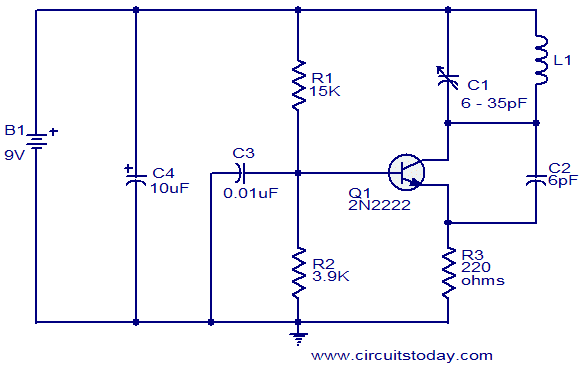

A circuit is here.

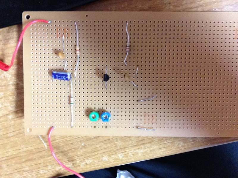

I built this circuit. People say a frequency is determined only by tank circuit and C2 is nothing to do with the frequency.
But when i change C2 value, the output frequency changes.
for example when C2 is 6pF 150Mhz, 12pF 120Mhz 18pF 108 Mhz.
why is this happening?
i'm struggling to fit the frequencty to FM range i.e. 90-100Mhz
I used C1=30pF and inductor 1uH, i get 150Mhz
which is totally disagreeing with the formula i.e. a reciprocal of (2 pi Root LC) = 29Mhz.
when i used 0.1uH it was still 150Mhz. It seems the output frequency is not solely determined by the tank circuit.
and I'm using low q factor variable capacitor. is this affecting this also?
edit : what is the official name of this circuit? I want to know the name to find information about this. people say it's not Hartley nor Colpitts.
24pf 98Mhz 30pF 92Mhz. Vpp is 500mV in Oscilloscope.
I connected 1000uF i.e. 10^9pF parallel to L. The frequency dropped from 105Mhz to 82Mhz.

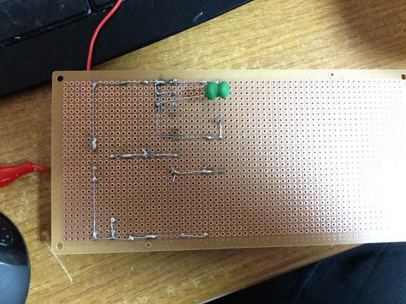

A thing I built on PCB.
also i used different transistor KSP2222A instead of 2N2222
Can you post a photo of your breadboarded circuit?
At RF frequencies layout becomes important.
Probably some of the resident Ham operators can see at a glance what's up.
my guess would be that your 1000 uf capacitor is an inductor at radio frequencies. That's why you usually see big electrolytics paralleled with a 0.1 ceramic.
It could be as simple as too long wires between battery and the transistor,
or your 10uf needs a small ceramic bypass. But I'm not a RF expert by any means.

I'd say Jim is spot on with his diagnosis (as usual). At VHF you can't use convenient low-frequency lay out construction techniques. Discard the breadboard, you should build most of this in mid-air like a rat's nest and supported by component leads, with component leads clipped very short. No ceramic caps in the RF circuit, they are hopeless here. The variable capacitor should be small, with air dielectric. Look at winding the inductor yourself, using an air-cored former and stout copper wire with turns spaced apart like you see in VHF equipment. The battery and electrolytic should be close to the transistor, with short leads.
So that your experiments do not disrupt radio signals on that frequency in your locality, house this in a shielded case or metal box, and Earth it.

It is not correct to say that C2 has nothing to do with the frequency of the oscillators operating frequency. Any time we hang something right on the tank it will affect the frequency. The emitter is a very low impedance point so naturally tying something to it is like tying it to ground. Xc of C3 at 100 Mhz is less than .25 ohm, so this impedance is lowered through the beta of the transistor even farther.

Any loop of wire has inductance so the approach is to minimize wire lengths. Especially around that tuned circuit.
You can build "in the air" as N O suggested over a copper clad board; the clad makes a good ground plane.

You have a common base amplifier with positive feedback via C2 to make it oscillate.
C2 sets the amount of feedback, which you want to go all into the emitter. Stray capacitance in parallel with R3 steals from your feedback so be careful there with layout. C3 should have short leads to keep base to ground impedance real low at RF.
I couldn't tell if your inductor is air core. If not, make sure it's core material is a variety good at 100mhz. Spec sheet for the inductor should say.

as I understood it, the inductor was just 6 turns of wire (which I didn't see in the circuit).
I'd guess it's the green object on the rear of the board.
Can't tell what it is
power chokes made for switching inductors probably aren't suitable
