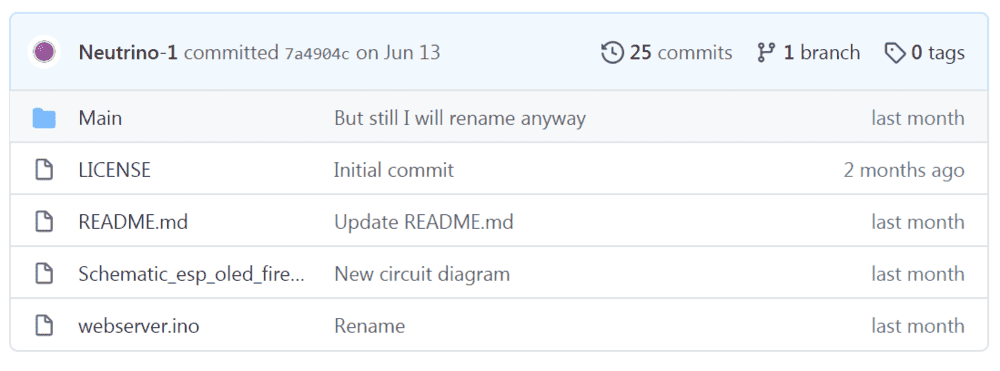

The code that is cited as the copyrighted code is completely unrelated to the code in the repository, which is all .ino (Arduino) files, and contains no Casio proprietary code.
The guy changed the project name and description to:
esp-oled-firebase-Integration
0.91" inch OLED and a esp8266-12E, which is integrated to firebase to fetch text file and send and receive text message.​
Here's the file list:

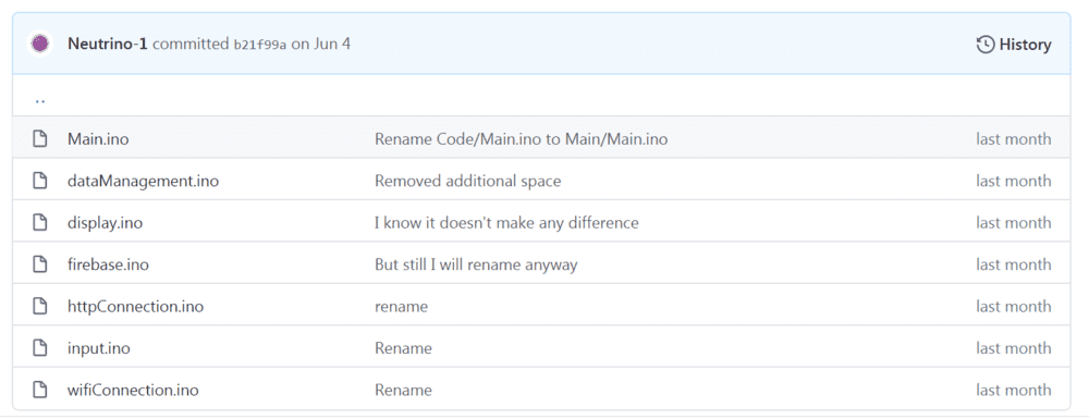

the 'main' subdirectory:
Two candidates that I looked at for possible infringement are the firebase code, and the data management code.

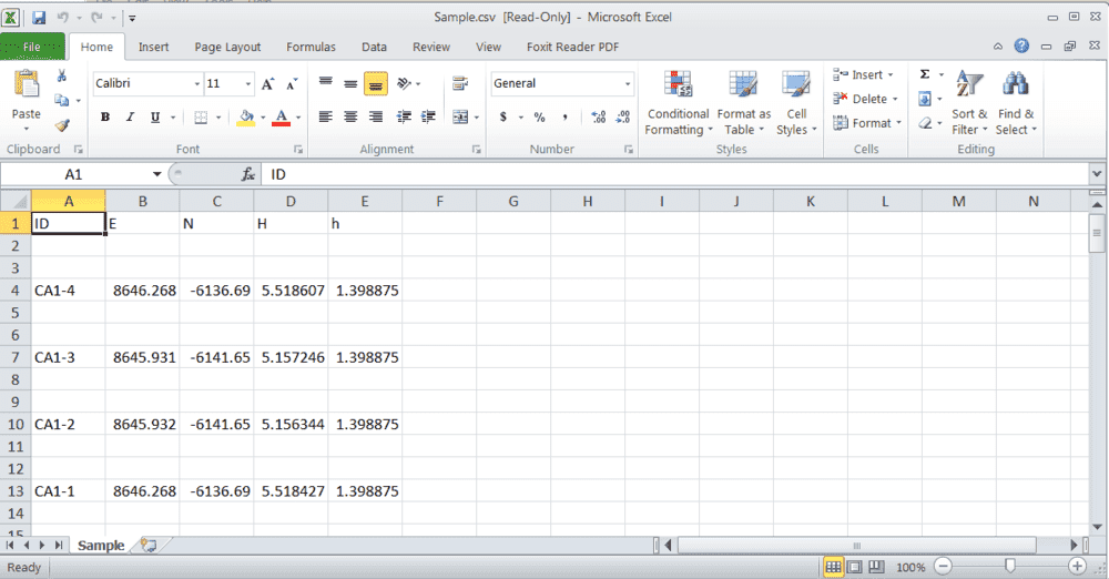

Downloading the Casio code from the link in the DMCA complaint requires agreeing to their license, and especially given that it's the subject of a DMCA complaint, I won't post it here. It's 59 lines of sample code for a fx-FD10 Pro that imports fields from a CSV file (using a USB connection) ##-## here's what that file looks like in Excel:

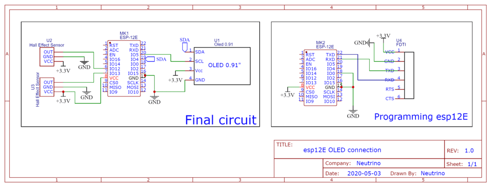

The Casio code clearly has no contributory relationship whatsoever to the project code. None of the project code has anything to do with the calculator. The project doesn't even use any of the fx-991MS calculator's hardware other than the case.
Everything runs in the wifi processor, input is entirely from the Hall Effect sensors, and output is only to the OLED screen that sits where the solar cell was. The project uses a battery, and let's the calculator use the battery for power instead of its no-longer-present solar cell.
