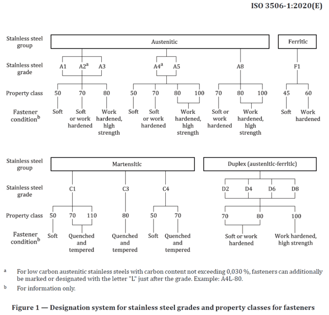

Stainless steel screws are denoted by their grade and property class (mechanical strength) in ISO 3506-1.
Flowchart from ISO 3506-1:2020 (Figure 1) showing the designation system for stainless steel grades and property classes for fasteners, with branches for austenitic, ferritic, martensitic and duplex groups.
So the material itself is not typically defined. The chemical composition is defined which is technically enough but information about the alloy is harder to find.

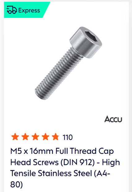

For example, you may know you're buying an A4-80 screw but you don't initially know the alloy.
Product listing photo of an M5 x 16mm stainless steel cap head screw with a hex socket, shown with a 5-star rating of 110 reviews and the title M5 x 16mm Full Thread Cap Head Screws (DIN 912) - High Tensile Stainless Steel (A4-80).
From other sources (or by matching the chemical composition), you may find that an A4 screw corresponds to an AISI 316 or stainless steel 18/10.

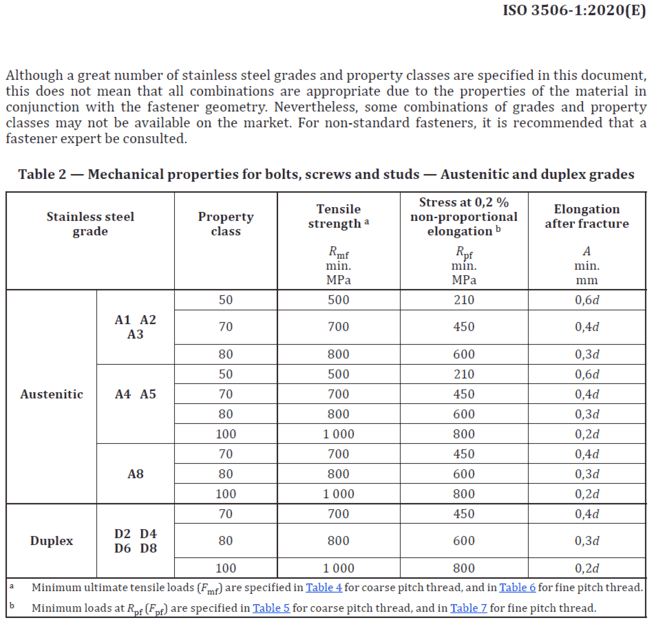

And here lies my question about the material. An A4-80 seems to have greater mechanical properties than what an AISI 316 has to offer.

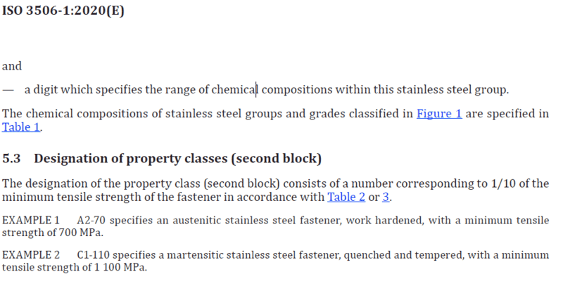

Here are the mechanical properties defined by ISO 3506-1.
Excerpt from ISO 3506-1:2020(E) section 5.3, Designation of property classes, with examples A2-70 for work-hardened austenitic stainless steel (minimum tensile strength 700 MPa) and C1-110 for quenched and tempered martensitic stainless steel (1 100 MPa).
Table 2 from ISO 3506-1:2020 listing mechanical properties of austenitic and duplex stainless steel bolts, with tensile strength, 0.2% proof stress and elongation by grade and property class.

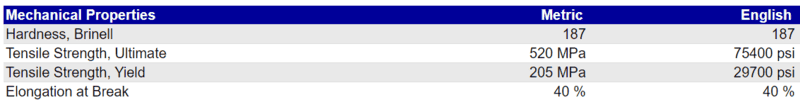

So those properties of an A4-80 are considerably above what's available in an AISI 316.
Table of mechanical properties with Metric and English columns: Hardness Brinell 187; Tensile Strength Ultimate 520 MPa (75400 psi); Tensile Strength Yield 205 MPa (29700 psi); Elongation at Break 40 %.
How is that possible? It can't be that it's simply work hardened because that moves the yield point to the right but it shouldn't increase the ultimate tensile strength.
Stress-strain curve with sigma = F/A on the vertical axis and epsilon = L/L on the horizontal axis, showing points 1 to 4, a 0.2% offset line, slope E marked, and a small diagram of a rod under tensile force F.
What am I missing?
This is the only instance I could find where the ultimate tensile strength comes near what is defined for the screws.
Still, I don't know how it's possible.
  • Excerpt from ISO 3506-1:2020(E) on stainless steel fastener designation, including section 5.3 on property class second block with examples A2-70 and C1-110.

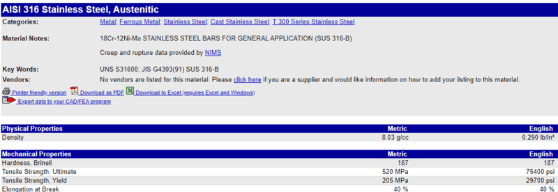

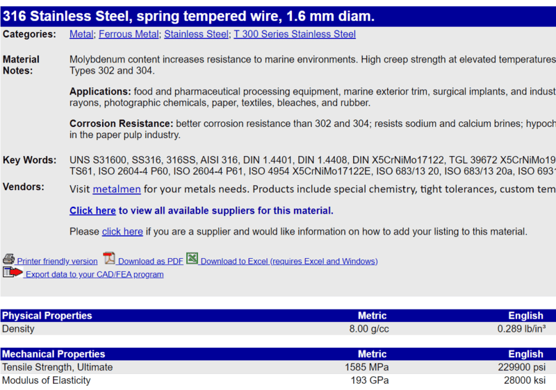

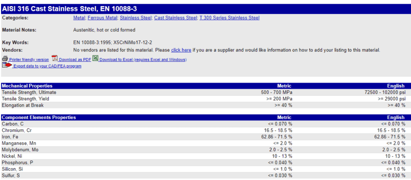

How can these three AISI 316 be so different from one another?
Datasheet for AISI 316 cast stainless steel, EN 10088-3: mechanical properties table (tensile strength 500-700 MPa, yield >= 200 MPa, elongation >= 40%) and component element limits for C, Cr, Fe, Mn, Mo, Ni, P, Si and S.
Materials data sheet for AISI 316 Stainless Steel, Austenitic, listing density 8.03 g/cc, hardness 187 Brinell, ultimate tensile strength 520 MPa, yield strength 205 MPa and elongation at break 40 %, in metric and English units.
Material datasheet for 316 Stainless Steel, spring tempered wire, 1.6 mm diameter, showing notes, key words, density 8.00 g/cc and tensile strength 1585 MPa, with a modulus of elasticity of 193 GPa.
How could I know what an A4-80 is really made of? AISI 316 seems to be insufficient since that classification contains a wide range of properties.

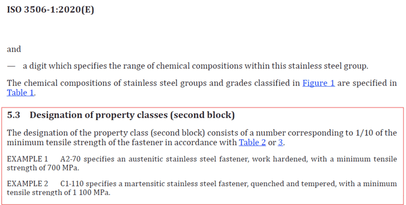

So that bit marked in bolt letters is new for me. I thought work-hardening (the net result of cold working if I understood correctly) could only increase the yield strength as shown in the picture previously shared and shown below again.

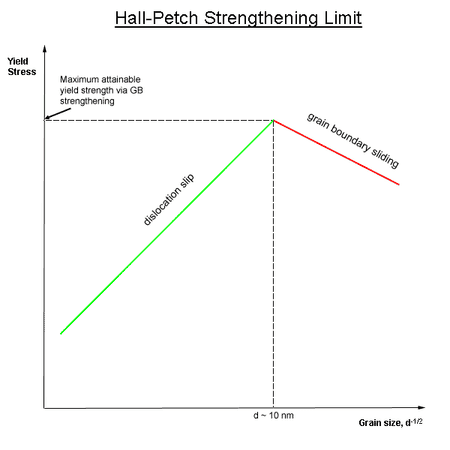

Astronuc said:
Hall-Petch strengthening limit graph: yield stress against grain size d^-1/2. A rising green line labelled dislocation slip meets a falling red line labelled grain boundary sliding at d ~ 10 nm, with a dashed line marking the maximum attainable yield strength via GB strengthening.
I don't see how grain boundary strengthening could change the ultimate tensile load. From what I could read, its impact is focused on the yield point which coincides with my previous understanding of how metals deform.
Also, grain size is determined by heat treatment so in any case, it'd be a separate point unrelated to cold-working they must be doing on the metals. It could be the reason the table shows the differentiation between soft and high strength (70 and 80 within A4) and I think you hit the nail with that one although the document doesn't show any additional clarification regarding what Soft vs High Strength means.

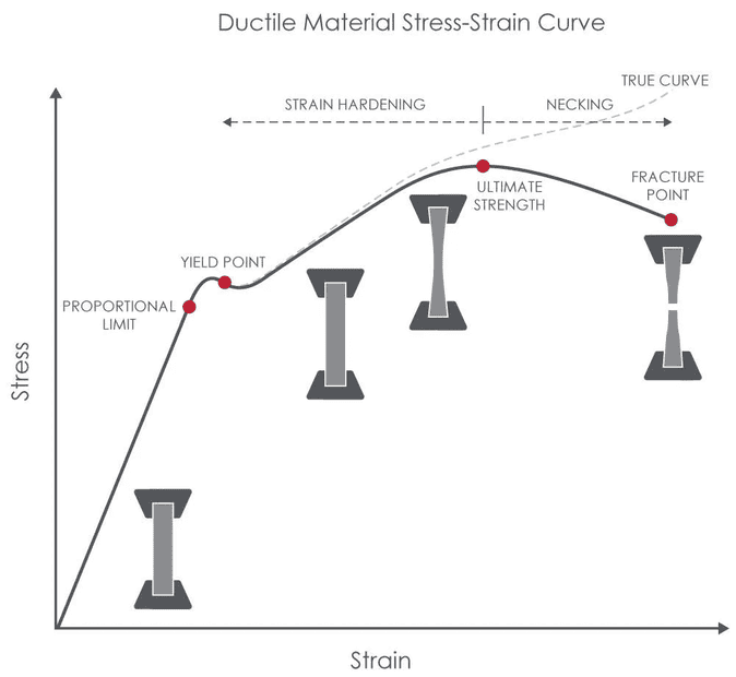

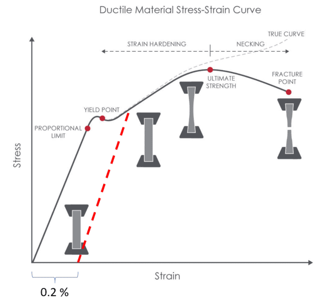

English is not my native language so for further clarification, I'm adding this picture.
Stress-strain curve titled Ductile Material Stress-Strain Curve, stress on the vertical axis and strain on the horizontal axis, marking proportional limit, yield point, strain hardening, ultimate strength, necking, fracture point and a dashed true curve.
Ultimate strength is what I have sometimes called ultimate tensile load.
I have also mentioned the 0.2 % elongation which refers to the proof load. From that last graph, it seems the yield point would be easily identifiable but in other graphs is not the case. That's why there is a need to keep loading it to notice the behavior change.
Stress-strain curve for a ductile material with the title "Ductile Material Stress-Strain Curve", showing proportional limit, yield point, ultimate strength and fracture point, with a 0.2 % strain offset marked and a red dashed offset line.
Still, proof stress seems to not have physical significance and it sometimes has different motivations so I think it just adds noise to this conversation. I suggest we avoid it.

Juanda said:
Is that picture wrong then? That would be equivalent to cold working and the ultimate tensile load doesn't increase.
The picture is not wrong, but that is only one cycle. One would have to repeat the test on the same specimen, which would show a greater yield (YS) and ultimate tensile strength (UTS), then repeat the test. Note that there is some permanent strain (deformation) once a material exceeds the proportional or yield strength. Above yield, the material is considered to 'flow' rather than creep. The close to the ultimate tensile strength, the greater the permanent deformation and subsequent YS and UTS.
There are two mechanisms operating in the austenitics.
‘Normal’ work hardening occurs as ‘dislocations’, (naturally occurring line defects that enable metals to be ductile), in the atomic lattice move during plastic deformation. With deformation the number of dislocations present in the metal tend to multiply. The stress fields around the dislocations interact due to their increased density, and the dislocations also form ‘tangles’, both factors contribute to the observed increase in the force required to move them. Individual ‘perfect’ dislocations can also ‘split’ to become two partial dislocations with an intervening stacking fault, where locally the structure becomes hexagonal close packed, HCP, rather than FCC. In those FCC metals/alloys with a low stacking fault energy, the area of stacking fault, i.e. separation of of the partial dislocations, can be quite large in relative terms. The importance of this is that the micromechanical processes known as cross slip and climb, which enable dislocations to bypass obstacles, other dislocations etc., require bringing the pair of partial dislocations back together. This is easier in high stacking fault energy alloys, and thus they work harden less rapidly. So the stacking fault energy of any FCC metal/alloy is a key parameter when it comes to work hardening. Alloying influences the stacking fault energy of the common FCC metals. This not so marked in the ferritic, (bcc), structure, as in this structure the stacking fault energy is considered to be very high, thus most dislocations are in their ‘perfect’ form and thus are able to climb and cross slip.
This is an advanced topic, and the reader is directed to academic texts such as, ‘Introduction to Dislocations’, by D. Hull and ‘The Plastic Deformation of Metals’, by R.W.K. Honeycombe, for a more complete picture of these micro deformation processes in metals.

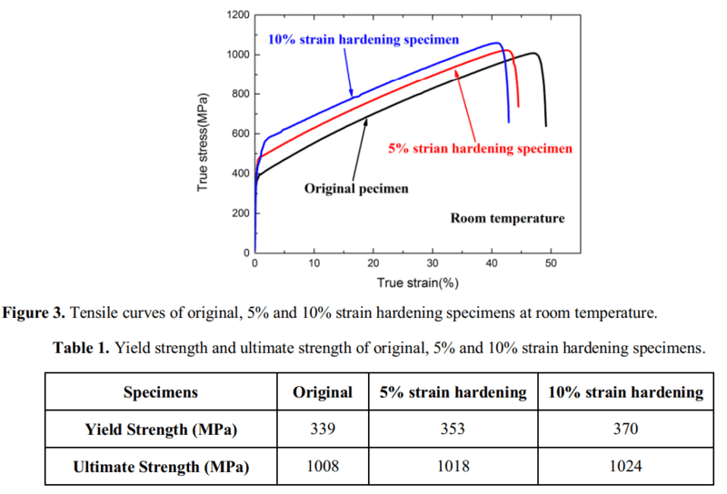

See some examples of strain hardening in this paper. Note the plot (Fig. 3) represents three separate tests.
Mechanical Behavior of 316L Stainless Steel after Strain Hardening

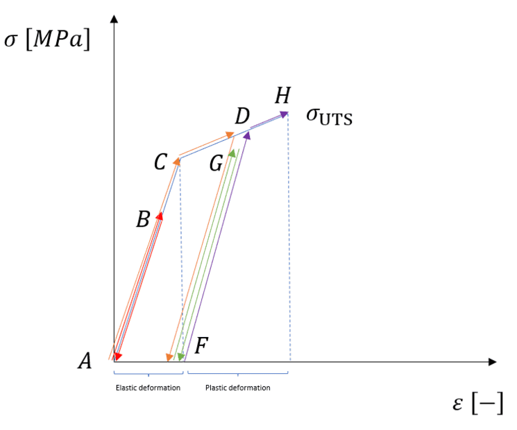

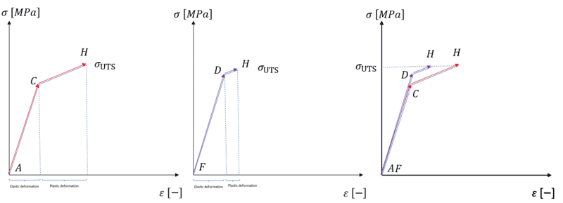

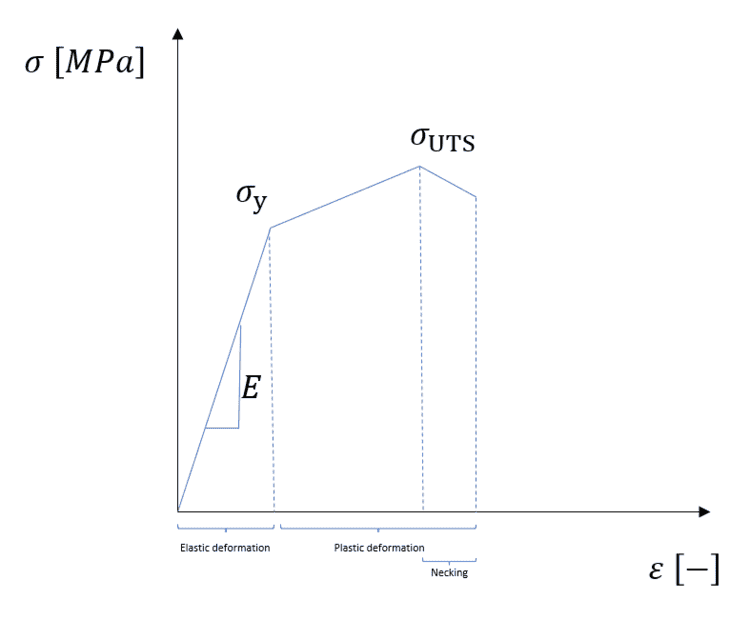

I'm having so much trouble understanding why the ultimate tensile strength (UTS) should increase due to the repetition of cycles...
I propose the following mental experiment. Imagine an extruded metal bar and cut it in half so both specimens can be assumed to have the same properties.
Let's use one of the specimens to determine the behavior of the metal on a tensile test. This is the result from the experiment (simplified so I can draw it more easily but with some resemblance to reality).
Stress-strain curve with sigma in MPa on the vertical axis and epsilon (dimensionless) on the horizontal axis, showing a linear elastic region with slope E, yield point sigma_y, a plastic region rising to sigma_UTS, then a drop labelled Necking.
The interpretation would be:
  1. The specimen is suffering elastic deformation. If the load was released, it'd come back to its original shape.
  2. The elastic limit (yield limit) ##\sigma_y## is reached. Beyond this point, the specimen will acquire a permanent deformation. The crystalline structure of the specimen is changed by sliding planes (dislocations) which also introduces more defects in the mesh during the process which increases the yield point of the specimen. The process goes on until the UTS ##\sigma_{UTS}## is reached.
  3. The UTS is reached because necking starts. I was wondering if I'd add necking to this idealization since necking is the result of a weak point somewhere in the specimen. In an absolute ideal world, the specimen would keep increasing the load uniformly along its length until failure. Since necking is a constructive defect (the reduction in the area causes a local increment in stress) as soon as it starts the maximum axial load is reached. I propose we ignore necking and just imagine the specimen snaps once ##\sigma_{UTS}## is reached.
Now, for the second specimen, I'll repeat the tensile test but I'll do it in steps/cycles as you suggested. My claim is that those cycles will increase ##\sigma_y## but not ##\sigma_{UTS}##. I'll plot first on top of the previous graph.
Stress-strain curve with stress in MPa on the vertical axis and strain on the horizontal axis, showing points A to H, the UTS marked at H, and elastic and plastic deformation regions, with colored loading and unloading paths.
  1. Cycle A→B→A (red). The specimen didn't reach its elastic limit so it comes back to its original shape without changes.
  2. Cycle A→C→D→F (orange). Yield has occurred. A new yield limit is established at D. F is the new resting length of the specimen.
  3. Cycle F→G→F (green). The specimen was permanently deformed in the previous cycle but this new stress cycle doesn't produce additional permanent deformation even if the stress level is above C which originally defined the yield strength. As mentioned in the previous cycle, the new yield limit is at D.
  4. Cycle F→D→H (purple). The specimen is loaded until the ultimate strength is reached (either it breaks or necking starts, I propose we ignore what happens beyond that point).
I don't see how adding more cycles would affect the UTS (ignore more complex things such as fatigue please). The yield point increases which has been established and accepted from early in the thread but the increment in UTS is still something I can't understand.
The load cycles could be shown starting from 0 but that changes nothing since the information is still the same. I consider the previous graph to be clearer for what we are discussing but I'll add these additional drawings because it's how it's usually shown in material's datasheets and a paper shared in the thread.
I'll show what I consider the relevant paths. This is A→C→H and F→D→H.
Three stress-strain curves labelled sigma in MPa against epsilon, showing elastic and plastic deformation regions, points A, C, D, F and H, and sigma_UTS marked on each curve.
Am I misunderstanding something in what I showed above?

I read the paper and it doesn't explain the increment in UTS either. In fact, in the introduction I read the following:
Tensile tests of 316H stainless steels with strainhardening up to 4%, 8% and 12% at room temperature in Ref. [4] found that the values of Young'smodulus and the ultimate strengths are similar for different strain hardening, but the yield strengthsincrease with the magnitudes of strain hardening at different temperatures.
That coincides with what was my previous understanding of how metals work. The origin of this thread is that statement collides with the huge variations in UTS shown in screws that are supposed to be made of the same material as shown in the OP.
The previous statement is also shown in Section 3 with the following graphs and table where you can see the relevant change in yield strength but the basically same UTS.
Line graph of true stress in MPa against true strain in percent for original, 5% and 10% strain hardening specimens at room temperature, with the 10% curve highest and the original lowest.
Even if there is a positive relation between strain hardening and UTS, the effect and number of tests from that paper are so small it'd be argued if the change is relevant at all. Even if it is, it is nowhere close to the huge change in properties I shared in the OP.

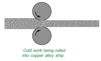

So far, the explanation I think covers the increment in UTS is related to this picture:
Source
Diagram of cold work being rolled into copper alloy strip: a strip with grain structure passes between two rollers, with arrows showing the rollers rotating in opposite directions.
Cold working could be any mechanical stress on the specimen such as a tensile test. Tensile tests will increase the yield point if the specimen is taken beyond the elastic region but the UTS will remain the same. However, if the specimen is cold worked in a specific way such as being rolled or extruded/pulled so the crystalline structure changes in a relevant way without breaking the parent material, the UTS can be increased.
For example, steel wire usually shows greater mechanical properties compared with a billet of the same material and according to what I found, screws are made of steel wire.
This of course would make the specimen more brittle just as shown earlier in this post but I think there is another relevant difference. The material would no longer show isotropic behavior because the crystalline mesh is no longer uniformly random. The UTS might have been increased in a particular direction but I feel it must have decreased in others.
Would you say this is correct?
The magnitude of change in UTS as a function of cold work, or strain, is less than the magnitude of change in YS. Normally, when one does a tensile test, one tests to completion, i.e., beyond UTS to failure. However, one can test to a strain less then uniform elongation, unload and reload, but then it's not the same material since some permanent (plastic) deformation has occurred.
One has to look at the composition, cold work and grain size of the alloy(s), each of which contributes to YS, UTS and elongation.
Austenitic steels are fcc (face-centered cubic), so the mechanical properties are essentially isotropic.
I have seen scatter in tensile tests where the measured YS varies from 80 to 110 ksi (550 to 760 MPa) for the same nominal material (with 20% cold work), and UTS varied from 110–125 ksi [758–862 MPa]. The nominal cold work of 20% is in actuality 18 to 22% CW, and grain size can also vary. A lot depends on the thermo-mechanical processing which is often done in cycles from billet to bar to rod (final draw after last solution annealing). How one anneals (temperature and time) can affect residual stresses carried over from the prior mechanical reduction.
Strain rate is yet another factor that affects tensile test results.
