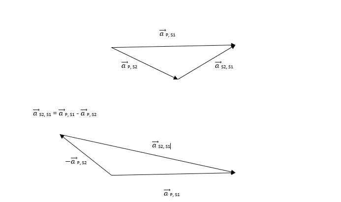

vela said:
Both diagrams are wrong. You made the same mistake earlier in the thread. See posts 5 through 9.
That said, your reasoning about the range of magnitudes of ##\vec a_{S1,S2}## is correct.
I'll add that you really shouldn't need us to confirm the correctness of your answers. You need to construct your understanding so that you can be reasonably confident on your own that an answer is correct, not relying one some authority to tell you that.
I haven't studied physics since 2010 and that was just basic stuff, so anything I think is correct is probably not.
Anyway, I hope the below is correct.
Two vector diagrams: top shows a_P,S1 as the closing side of a triangle with a_P,S2 and a_S2,S1; bottom shows a_S2,S1 as the closing side of a triangle with a_P,S1 and -a_P,S2, with the equation a_S2,S1 = a_P,S1 - a_P,S2 written above.
Monsterboy said:
I haven't studied physics since 2010 and that was just basic stuff, so anything I think is correct is probably not. Anyway, I hope the below is correct.
We all make mistakes, so it's important to develop the ability to check your work and find those mistakes. For example, when you drew the first diagram, you could have also written down the equation it represents by interpreting the diagram. Then you would have hopefully seen the subscripts were messed up and realized the diagram had a problem. By getting in the habit of looking at the same concept in different ways, you'll start to see how they all fit together.

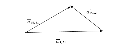

Monsterboy said:
The second diagram is still wrong.
Ok, when I tried parallelogram, I figured I was putting ##-\vec{a}_{P, S2} ## on the wrong side.
Vector triangle with three arrows from a common tail: a_P,S1 along the base, a_S2,S1 on the upper left side, and minus a_P,S2 on the upper right side, which connects the tip of a_S2,S1 back to the tip of a_P,S1.
This must be right.
That's right. :smile:
