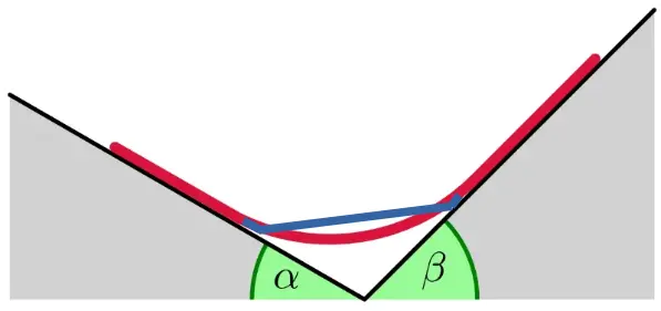

A homogeneous cord rests on a pair of connected, rigid slopes with adjustable inclination angles, as shown in the figure. The coefficient of friction between the slopes and the cord is ##\mu##. How should we choose the inclination angles ##\alpha## and ##\beta##, and how should we deposit the cord to make the length of its hanging middle section maximal?
Newton's ##2^{\text{nd}}## Law of motion, some Calculus.
Let us take an infinitesimal piece of cord, long ##\mathrm ds##, resting on a plane inclined at an angle ##\theta## to the horizontal. The weight of the elements is ##\lambda g \, \mathrm ds##, where ##\lambda## is the linear density of the cord. The component parallel to the plane (directed downwards) is ##\lambda g \sin \theta \, \mathrm ds##. The normal reaction is ##\lambda g \cos \theta \, \mathrm ds##, so the maximum static friction available (directed upwards) is ##\mu \, \lambda g \cos \theta \, \mathrm ds##. Writing the axial equilibrium (positive upward direction) according to Newton's ##2^{\text{nd}}## Law of motion: $$T(s+ \mathrm ds) - T(s) = \lambda g \, \mathrm ds \left(\mu \cos \theta - \sin \theta \right), \tag{1}$$ and taking the limit ##\mathrm ds \to 0## on the LHS, we have ##T(s+ \mathrm ds) - T(s) \to \mathrm dT##; so, ##(1)## becomes $$\mathrm dT = \lambda g \, \mathrm ds \left(\mu \cos \theta - \sin \theta \right). \tag{2}$$ Integrating ##(2)## from the top end of the rope ##(T_{\text{top}} = 0, \, s = 0)## to the point where the rope detaches from the slope ##(T_0, \, s)## gives $$T_0 = \lambda g \, s \left(\sin \theta - \mu \cos \theta \right). \tag{3}$$
Now, let's work with two inclined planes (angles ##\alpha## and ##\beta## with respect to the horizontal plane).
If we call the two tensions ##T_{\alpha}## and ##T_{\beta}## for the values of ##T_0## at the two sides (they will not be equal) and ##s_{\alpha}## and ##s_{\beta}## as the lengths in contact with the slope at the two sides, then equation ##(3)## tells us the relationship between ##T_{\alpha}## and ##s_{\alpha}##, and also between ##T_{\beta}## and ##s_{\beta}##. We have
$$T_{\alpha} = \lambda g \, s_{\alpha} \left(\sin \alpha- \mu \cos \alpha \right) \tag{A}$$ and
$$T_{\beta} = \lambda g \, s_{\beta} \left(\sin \beta- \mu \cos \beta \right). \tag{B}$$
We have other constraints as well, because
- the net horizontal force on the rope must be zero, so we get $$T_{\alpha} \cos \alpha - T_{\beta} \cos \beta = 0 \iff T_{\alpha} \cos \alpha = T_{\beta} \cos \beta. \tag{C}$$
- if we suppose the length of the unsupported rope is ##\ell##, then its weight is ##\lambda g \, \ell## has to be supported by the force at the two ends of the unsupported section, i.e. by the vertical component of the tension ##T_0##. So, the total upwards force must equal the weight of the unsupported rope, and we get $$T_{\alpha} \sin \alpha + T_{\beta} \sin \beta = \lambda g \, \ell. \tag{D}$$
From ##(\text{C})##, we have ##T_{\beta} = T_{\alpha} \, \dfrac{\cos \alpha}{\cos \beta}##. Plugging the expression ##(\text{A})## for ##T_{\alpha}## into the previous equation, we get $$T_{\beta} = \lambda g \, s_{\alpha} \left(\sin \alpha- \mu \cos \alpha \right) \dfrac{\cos \alpha}{\cos \beta}. \tag{B1}$$
Plugging the expressions for ##(\text{A})## and ##(\text{B1})## into ##(\text{D})##, we get $$\cancel{\lambda g} \, s_{\alpha} \left(\sin \alpha- \mu \cos \alpha \right) \sin \alpha + \cancel{\lambda g} \, s_{\alpha} \left(\sin \alpha- \mu \cos \alpha \right) \tan \beta \cos \alpha = \cancel{\lambda g} \, \ell,$$ or, equivalently, $$\boxed{\frac{\ell}{s_{\alpha}} = \left(\sin \alpha- \mu \cos \alpha \right) \left(\sin \alpha + \tan \beta \cos \alpha \right)}.$$
Here I am stuck, because I can't understand how to find the maximum angles ##\alpha## and ##\beta## that maximize ##\ell##.

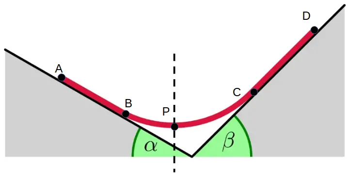

The trick for cables hanging under their own weight, the horizontal force is the same through the entire cable. The lowest point in cable has only horizontal forces. The angle of the cable is the amount of weight (vertical force). The angle gets steeper and steeper as more and more weight is held under it.
Pretend the cable is a paper chain of people - holding hands. If you were one of the people in the chain, which person would you like to be? Ans: the person at the lowest point in chain has it good, is held up by everyone above them. The person at the highest point has to hold up everyone under them - has both the weight, and that horizonal force too.
Read wiki about Caternary, and analyze the free-swinging piece of the rope.

The question seems incomplete. Shouldn’t there be some limit on the total length of the rope? Or should we interpret it as asking for the fraction of unsupported rope to be maximised, ##\frac l{s_\alpha+s_\beta}##?
I feel there’s a constraint you are not using, that the hanging rope is tangential to the slopes at point of contact. Maybe use the catenary equation.
What do you mean by "some limit on the total length of the rope"? If you mean that the rope must have a total length ##L = \ell + s_\alpha + s_\beta##, well, I think so.

Refer to your drawing in post #1. Suppose that you found a specific solution ##\alpha = \alpha_1## and ##\beta = \beta_1## that maximizes the hanging section. By symmetry, it follows that the choice ##\alpha = \beta_1## and ##\beta = \alpha_1## also does the job. What does this tell you about the relation between ##\alpha## and ##\beta## ? I suggest that you start from there.
This is interesting, because it seems to get to the core of my trouble with angles.
Well, intuitively, I would say that the relationship between ##\alpha## and ##\beta## you ask is ##\alpha = \beta##. But I cannot give a precise rationale for this. And it would not be clear to me why the two angles should be equal.

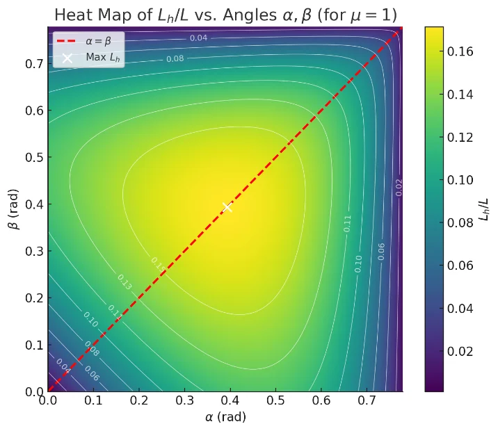

I assume you mean maximise ##l## wrt ##\alpha, \beta##.
What’s wrong with writing ##\frac{\partial l}{\partial \alpha}=\frac{\partial l}{\partial \beta}=0##?
Assuming the angles are equal in the solution probably gives the right answer, but it is not guaranteed. Consider the function ##((x-a)^2+(y-b)^2)((x-b)^2+(y-a)^2)##. Clearly it has minima at ##(a,b), (b,a)##.

Setting ##\dfrac{\partial \ell}{\partial \beta}=0## gives me ##\alpha = \arctan \mu##, and setting ##\dfrac{\partial \ell}{\partial \alpha}=0## gives me ##\beta= - \arctan \mu##.
I can write down the maths, but it is a bit tedious. And these results are not so convincing.

Well, I am able to derive expressions in the case where the shape is a catenary. But in general, no, because ##s_\alpha## and ##s_\beta## depend on ##T_\alpha## and ##T_\beta##, for which the expressions are different depending on the shape of the cord (?)
The final answer is ##\alpha = \beta = \dfrac{\arctan \mu}{2}##. But, it is not at all obvious to me why ##\alpha=\beta## necessarily. Post #5 by @kuruman seems to go this way, but I am not sure.

Meden Agan said:
In Morin's problem, however, the situation is fully symmetric, with ##\alpha = \beta = \theta##. In this version, however, the two angles are not equal for assumption. It is neither obvious nor taken for granted that they should be (as would then turn out to be the case).
It should be labelled at “undergraduate level”.
The symmetry of the solution to the general problem is not unexpected; but, like you, I don't see how to justify it.
I don't think I can add anything else.
Hope someone can help us find out!
Isn't this a balance act between friction force and tension?
If so, it can't be but symmetrical.
What would happen at the extreme end of those angles?
As both angles tend to zero, it is all friction and no tension.
As both surfaces and rope halves tend to be vertical, it is all tension (induced by weight) and no friction (no normal forces induced by non-suspended weight).
Steve4Physics said:
Consider the fully symmetrical case: ##\alpha = \beta, s_{\alpha} = s_{\beta}##. This is manageable as each straight section of cord supports exactly half the weight of the hanging part - so the shape of the hanging part (catenary or not) doesn’t matter in this case. You can express (for example) ##s_{\alpha}## as a function of ##\alpha## and then minimise ##s_{\alpha}##. This may correspond to the general solution but I don’t see if/how that could be justified.
How if we chop the problem in half? At the point where the rope is horizontal, replace the right half with a vertical wall to which the rope is anchored. If we find the ##\alpha## maximising the fraction of suspended rope, subject to the rope meeting the wall at a right angle, the full solution must work also for the right half (and provide matching horizontal tension at the join).
Remember it’s not just the angles (##\alpha## and ##\beta##) that can vary independently, it’s also the contact-lengths (## s_{\alpha}## and ## s_{\beta})##. There are four variables to be juggled.
For a given value of ##\mu##, the frictional force on each side depends on both the angle and contact-length on that side.
I’ll make up some values for illustration – they’re not to be taken literally.
Suppose we have the symmetrical case, where for some given value of ##\mu## the maximum length of the hanging-section occurs when:
##\alpha = 40^\circ, s_{\alpha} = 0.25L##
##\beta = 40^\circ, s_{\beta} = 0.25L##
The length of the hanging-section is then ## L – 0.25L – 0.25L = 0.5L##
The problem is to rigorously prove that there isn’t another (asymmetrical) configuration which can make the hanging-section longer, for example:
##\alpha = 10^\circ, s_{\alpha} = 0.1L##
##\beta = 50^\circ, s_{\beta} = 0.3L##
In this case the maximum possible length of the hanging-section would be ## L – 0.1L – 0.3L = 0.6L##.
Or maybe I’m missing some simple argument.
Introducing the asymmetrical situation may not be needed, I believe.
It seems not to be a natural balanced situation to me.
For very small angles, the magnitude of the tension would tend to infinite.
The available static friction and the tension decrease at different ratios as the angles increase.
The condition of balance seems to happen when both values (tension and friction) coincide (interception of two curves perhaps).
That's exactly it. Again, post #5 by @kuruman suggests a preliminary relationship between ##\alpha## and ##\beta##. But, I cannot understand their hint.
In this problem, there is nothing in the physical situation to distinguish left from right. The gravitational field is uniform and vertical. It can only distinguish "up" from "down". Suppose you solve this problem looking down at the diagram in post #1 and you find that the maximum requires the angle on the left labeled ##\alpha## in the diagram be smaller than the angle on the right labeled ##\beta##. Should you be confident that you solved the problem correctly?
The answer is "No". If the correct solution necessitates the angle on the left to be less than the angle on the right, then an observer looking at the same diagram from behind the screen will disagree with you about which angle ought to be smaller because his left side is your right side. If there is nothing in the physical situation to distinguish left from right, then you are not, and should not be, in a position to do so.
Contrast this with the physical situation where one incline is more slippery than the other by having a smaller coefficient of static friction than the other. Aha! This removes the symmetry and you can draw conclusions such as "the angle with the smaller coefficient of static friction should be the smaller of the two."
If we could anchor the ends of the homogeneous cord to the rigid slopes (which could be seen as having infinite available friction), the cord would form a beautiful catenary for any adjustment of the inclination angle we choose (symmetrical or not).
In that case, the length of the hanging middle section of the cord would be maximal and equal to its natural length.
The opposite situation would be true for a coefficient of friction between the slopes and the cord equal to zero: there would be no catenary or any length of hanging middle section of the cord.
We should deposit the minimal length of the cord on the rigid slopes (smaller angles induce bigger friction) in order to make the length of its hanging middle section maximal and pulling as little as possible (greater angles induce less pulling tension on the end length of the cord).
Although personally unable to follow the math to calculate it, I see a convergence toward a balancing angle, at least for the symmetrical case.
As I noted in post #8, it is not quite that clear. You could find there are two values for ##\alpha## and ##\beta##, and it does not matter which is which as long as one takes one value and the other takes the other.
Is that likely? No. Is it possible? Yes.
Read the posts, but still have doubts.
I calculated ##\ell## if the cord is a catenary, and for ##\alpha = \beta## the result is the same as in post #6 (not accounting for the catenary equation). You guys pointed out the problem only makes sense if ##\alpha = \beta##. So, should I conclude that the cord shape doesn't affect the expression for ##\ell##?
Agree 100%.
The problem is the possibility of a pair of solutions such as these :
Solution-1:
and
Solution-2:
##\alpha = 50^\circ, s_{\alpha} = 0.3L##
##\beta =10^\circ, s_{\beta} = 0.1L##
These describe the same (assymetrical) configration - seen from the front and from behind. There is the possbility that the length of the catenary for each solution is the required maximum.
Edit - typo's
