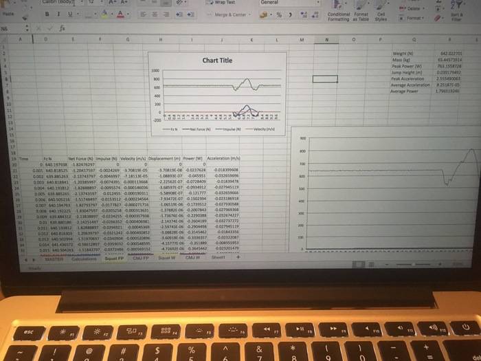

thank you for your response ill take some screen shots and send them to you now if that's ok...the first ones will be of the the force plate break down which I think is correct as I'm getting jump height and peak power etc which looks about right...it's the second tab I'm struggling with to calculate all the variables from acceleration...you'll notice in this one I'm not calculating peak power or jump height at all...both are one rep of a squat taken simultaneously. Thank you so much I've wasted about 3 weeks now going round in circles.

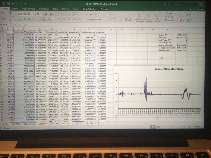

Here is my spreadsheet, I'm currently working on one rep of the squat and counter movement jump so you should see 4 tabs:
Squat fp think this is correct
Squat w needs work as these are the calc I'm trying to figure out from acceleration magnitude alone
CMJ fp think this is correct
CMJ w as above
I'm hoping the acceleration from the wearable is similar to that of the FP
Many thanks...
Thank you for any guidance x

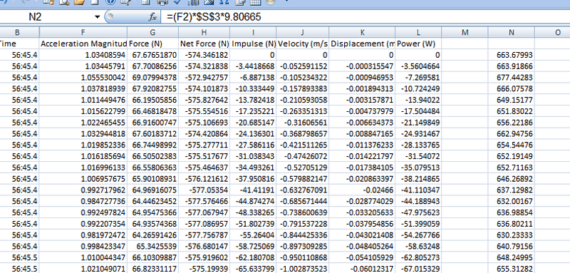

Hi I attached my spreadsheet with all the equations within. Here you can see how I've worked out every variable and like before I trust the force plate data is correct it's the wearable acceleration data that I'm struggling to covert
OK, I see the actual workbook now.In trying to evaluate the second sheet, one thing I find that disturbs me is that there is a very large variance in the weights when calculated based upon the imported acceleration values. See the below screen shot column N of the few examples I calculated.

It was difficult for me to judge how much accelerometer output "noise" existed during what should have been a relatively static period leading to to the actual squat cycle. (A constant 1.000 value representing the acceleration the accelerometer experiences due strictly to gravity). As a result, I decided to try converting those outputs and your reference mass to calculate an equivalent weight for each accelerometer value. Where was the wearable accelerometer mounted during the test? If it was mounted somewhere on your body (like your arm) that could move independently of the actual motion of the squat then that could explain why there is a lot of variations in my reference weight calculation values.
There is an additional issues I suggest you consider:
Based upon the above, it appears to me that, as opposed to your method of calculating your impulse based upon the total accelerometer output, your actual input acceleration value for your squat should be based upon the difference between the accelerometer value and the static gravity value of 1.000 that the accelerometer experiences due strictly to gravity even when you are not moving at all.
After an additional bit of review, another general issue related to your calculations of velocity for both sheets is that you use a*t to calculate the total velocity at the end of each time period when I believe the correct formulas for the final velocity and total distance traveled at the end of each time segment n should be: v@n = v@(n-1) + t@n*(a@n - g) and then d total @n = 1/2*v@n*t@n + d@(n-1)
Edit: Followup on the velocity calculation, it works OK on the short term period of a cycle but over a sustained time period there is a bit drift in the accelerometer's readings that cause an accumulated 0 point error in a long term plot that I cannot figure out how eliminate other than by trucating the curve and resetting the reference "1" g value.

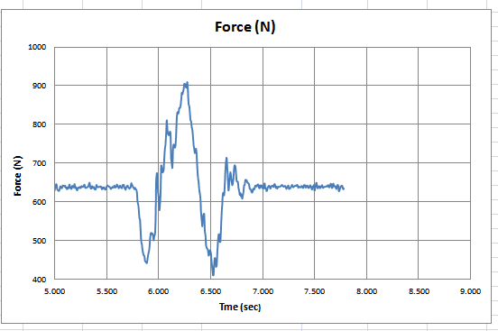

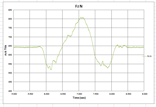

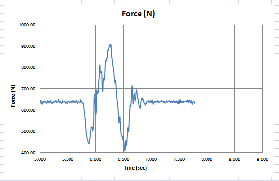

That makes sense. On the equivalence of the accelerometer and force plate readings the best way to deal with that is to use the Fz N for both by converting the accelerometer values to an equivalent effective weight using Fz N = g reading x Weight (N) rather than Fz N = g reading x Mass. Once you do that, and focus on the 6 to 8 second period of the actual squat then you will see that the resulting accelerometer curve generally matches the profile of your force plate curve but for some reason exhibits a variance in the squat duration time with the time intervals of 0.001 sec for the force plate and 0.006 sec for the accelerometer you specified and; unfortunately has an increased range of Fz N values as seen in the below graphs copies
Note: The start time for the second graph has been normalized to match the start point time of the first graph

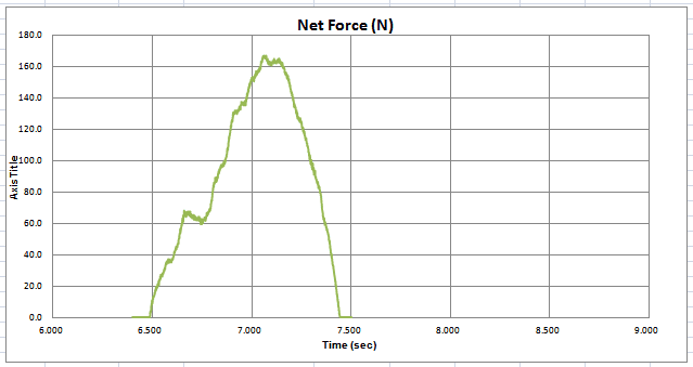

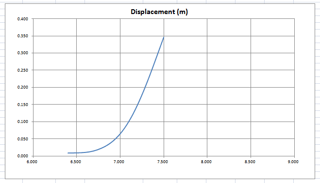

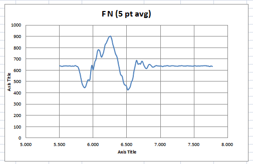

As a result, I have been taking some time to see what I could do with this in Excel (by modifications to a copy of your Excel workbook) just for my own enjoyment and on both the force plate and the accelerometer recordings. On the accelerometer recording, one technique I have used to smooth out some of the noise in the squat data curve is to first calculate and F N using: F N = accel x (your reference wt) and then create a successive F N set of values by doing a running 5 pt (two values below through two values above) averaging on each original F N value . You can use the same technique directly on your G values if you prefer.
Next, since only the > 1 G values are important during the squat for data you want I then used an F net = if( F N >= (your ref wt), F N - (your ref weight) ,0) statement to eliminate all of the negative F net values. (PS You can also use the if statement on your force plate and since that curve is must cleaner, that process automatically isolates exactly those positive force values you need for the further analysis.)
Below are the resulting successive plots using those procedures.

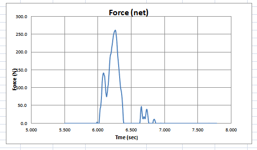

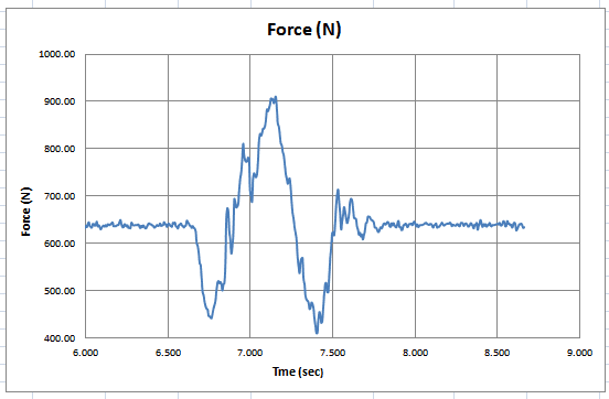

As stated, for the force plate, I am able to isolate the force curve for any single squat thrust using the method I described and therefore the data you desire just as you apparently can do; unfortunately, when it comes to the wearable there is considerable pre-thrust acceleration greater than G = 1 noise, so I have not figured out so far any method that will allow excel to automatically isolate the desired thrust region.
One issue that concerns me that I have wanted to ask you about is that on the two relative plots is the difference in the apparent time interval for the squat thrust. For the force plate record the time for the positive F net is approximately .96 sec, but for the wearable positive acceleration it is only approximately 0.4 seconds. Do you have any explanation for this time period differential in the two records?

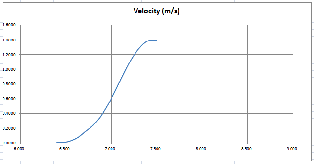

Just for your information below are the successive F net, Velocity and Displacement curves from my Force Plate analysis.
