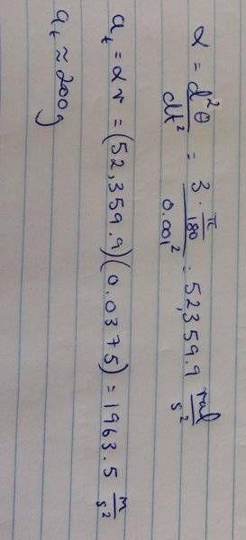

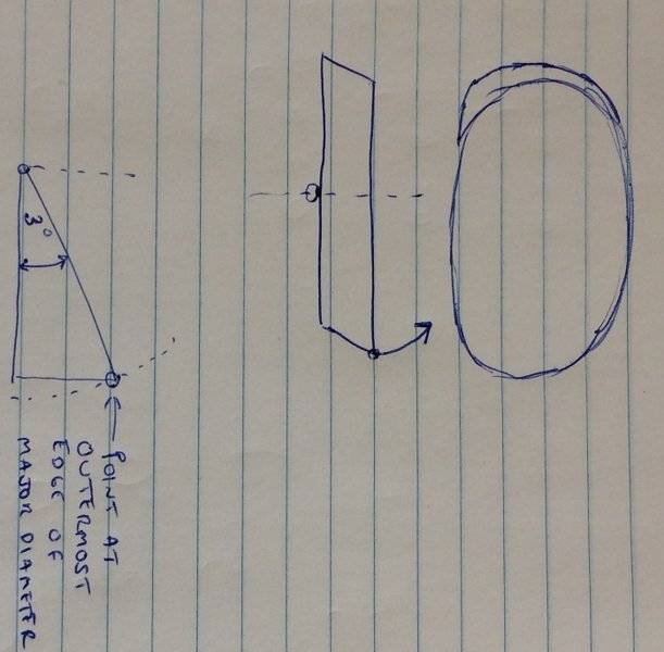

Hi all,
I need to bond the back surface of an elliptical mirror (75mm major diameter and 37.5mm minor diameter) onto a voice-coil actuated mirror mount that is going to be operating at 500 Hz and has an adjustment range of +-1.5 degrees. I need to determine the g-force likely to be acting on the mirror to determine the amount of adhesive that I need to use.

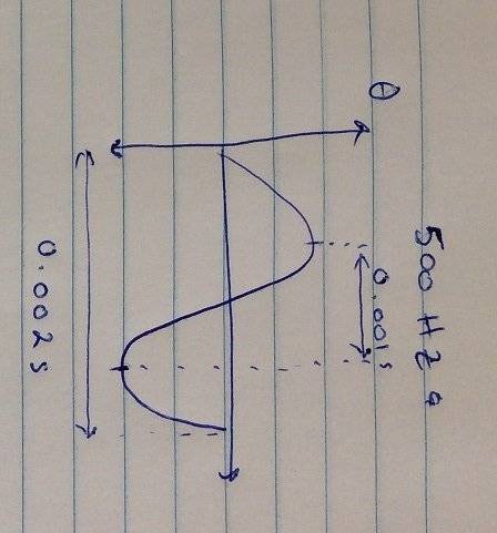

To do this calculation I am examining a point on the outermost 'edge' of the mirror as shown in Fig 01 attached. I am assuming curvilinear motion in that the point is rotating around a central point (essentially a see-saw action). I am only interested in the range of motion from the mount's total range of motion, so from the very bottom of its travel to the very top: 3 degrees, as shown in Fig 02. The time period for one total oscillation is 2ms, but I'm only interested in half of that as shown in the sketch, 1ms.
From here I simply calculate the angular acceleration, and then the tangential component of that, see Fig 03. I divide the tangential acceleration component by 9.81 to get the number of g's.
I'd just like some comments about whether this is the correct approach or not. It's been quite a while since I've had to do anything theoretical.
I thought a decent way to double-check might be to analyse this as a simple harmonic motion problem also, but I'm not too sure about that.
Thanks,
Doc
  • Hand sketch of the mirror setup: a small triangle with a 3 degree angle marked, labelled 'point at outermost edge of major diameter'; a rotated bar with a pivot dot and curved arrow; and a hand-drawn ellipse outline of the mirror.

  • Handwritten sketch of a sinusoidal angle-versus-time plot with a theta axis, labelled 0.002 s for the full period, 0.001 s for half, and 500 Hz.

  • Handwritten calculation of angular acceleration: alpha = d²θ/dt² = (3 × π/180)/0.001² = 52,359.9 rad/s²; then a_t = α r = (52,359.9)(0.0375) = 1963.5 m/s², a_t ≈ 200 g.

I attached photographed hand-written calculations in post #1. I calculated the angular acceleration and converted to a tangential acceleration for a point on the edge of the mirror's major diameter. This calculation yielded about 200 g's.
OK, let's go back to basics. If there is angular acceleration, there must be a torque acting on the mirror. To have a torque, you need a force applied at some non-zero lever arm from the axis of rotation. What is the force in this case and where is it applied? It seems to me that the external force is applied at the center of mass of the mirror and the torque about the center of mass that might cause rocking is zero. Another way to say this is, what reason does the mirror have to rock "right to left" as opposed to "front and back", or in between? There must be some asymmetry in the driving force with respect to the center of the mirror in order to introduce rocking motion and angular acceleration. I think what you have to worry about is the maximum linear acceleration and whether the mirror will peel off if it reaches maximum distance from the coil and is about to move backwards.
