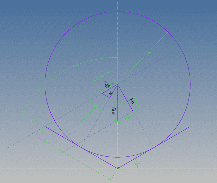

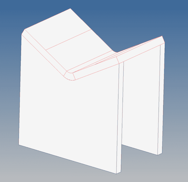

Hi,
a newcomer here. I need to know the value(s) of the force(s) acting on each inclined face of a double ramp. Here's a visualisation of a double inclined ramp (just an example, could be asymmetric):
Imagine a body rests on the top faces, let's assume it's a circular bar (a cylinder) which exhibits contact with each face at the line near the middle of the V-shape height.

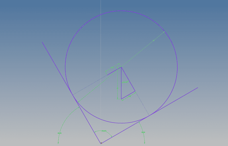

Let's first assume a symmetric ramp.
Now, I've drawn a section view with half of the forces (please excuse the lack of arrowheads - the dotted lines are just construction geometry, solid lines are geometry/forces):
The vector decomposition in itself seems pretty straightforward but I just don't know which forces contribute to the force exerted on each half of the ramp (or the reaction forces if you will). Or, at least, I'm not sure if I'm right.
I thought that we have a situation where the force in question should be the sum of Fn
and Fd for each half.
Fn is the perpendicular component of the force of gravity acting on the body (0.5*mass*gravity*cos(30))
Fs is the parallel component of the force (0.5*mass*gravity*sin(30))
Fd is a decomposed component of Fs acting along the line of contact.
But then there's this other component of the Fs left behind.
Now that I come to think about it when typing - if the left side of the ramp was a wall perpendicular to the right side of the inclined plane then the reaction force acting on the left side would have been just Fs like so:
and if the ramp was symmetric both those forces would be equal - 45deg inclination angle.
If we vary the inclination angle on one side the center of gravity moves. Unless the angle between the inclination planes is 90 deg I think I'm getting some fallacy...cause if I change an angle on one side only (left) the forces keep the value while the angle under which Fs acts changes.
Could someone point me in the right direction please?

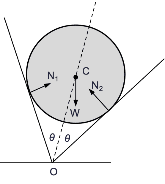

Just to make sure what you are asking. On the right is shown a correctly drawn FBD for a cylinder of weight ##W## resting on an asymmetric angle. Assumed given are angle ##\theta## and the angle that the weight forms with the vertical direction.
Is your goal to find the contact forces ##N_1## and ##N_2##?

You have 3 forces acting on the body that need to add up to zero (vectorially). The same applies to the moments generated by those 3 forces (e.g. around the bodies center of mass).
To get a unique solution, you would need to assume the contact is friction-less, which constrains the directions of contact forces to the surface normals, so you have 2 unknowns (contact force magnitudes) and 2 equations (force and moment equilibrium).
Allright, I know the equilibrium rule. The issue is I don't know which vectors take part in the solution so I can't write them down and solve...
In all cases where inclination angle is different from 45o (or 0) the gravity force decomposes to normal force component and parallel component which does not act along the line of contact on the other side of the prism. Should the parallel component be further decomposed and what happens with the other remaining portion of the force?

Just look at the diagram provided by @kuruman :
Assuming no friction and circular shape, all moments around C are zero, so you are left with the force vector equilibrium:
W + N1 + N2 = 0
When you split this equation into horizontal and vertical components (using known angles and trigonometric functions), you get 2 equations, and two unknowns (magnitudes of N1 and N2).

Look at the drawing on the right. It is self-explanatory. The unit vectors ##~\mathbf{\hat t}_1##, ##\mathbf{\hat n}_1## are in directions parallel and perpendicular to the incline on the left and likewise we have ##~\mathbf{\hat t}_2##, ##\mathbf{\hat n}_2## for the incline on the right.
Angle ##\theta## is the half-angle of the double-inclined plane and angle ##\varphi## is the angle by which the bisector of the double-inclined plane is tipped away from the vertical.
The goal is to express ##\mathbf{\hat n}_1## and ##\mathbf{\hat n}_2## in terms of the Cartesian unit vectors ##~\mathbf{\hat x}## and ##~\mathbf{\hat y}##. To do this, we first find ##~\mathbf{\hat t}_1## and ##~\mathbf{\hat t}_2## and then find the perpendicular vectors in the right direction. Formally, a 2D vectors is written as $$\mathbf{A}=A\cos\!\alpha~\mathbf{\hat x}+A\sin\!\alpha\mathbf~{\hat y}$$where angle ##\alpha## increases counterclockwise from the positive x-axis.
For ##\mathbf{\hat t}_1##
$$\alpha=2\theta+90^{\circ}-(\theta+\varphi)=90^{\circ}+(\theta-\varphi)\implies
\begin{cases}
\cos\!\alpha=-\sin(\theta-\varphi) \\
\sin\!\alpha=\cos(\theta-\varphi)
\end{cases}
$$Thus, $$\mathbf{\hat t}_1=-\sin(\theta-\varphi)~\mathbf{\hat x}+\cos(\theta-\varphi)~\mathbf{\hat y}.$$To find ##\mathbf{\hat n}_1##, you swap the components of ##\mathbf{\hat t}_1## and change the sign of one of them making sure that the normal points in the desired direction. $$\mathbf{\hat n}_1=\cos(\theta-\varphi)~\mathbf{\hat x}+\sin(\theta-\varphi)~\mathbf{\hat y}.$$Note that ##\mathbf{\hat n}_1\cdot \mathbf{\hat t}_1=0## which means that the two are perpendicular and that both components of ##\mathbf{\hat n}_1## are positive as expected.
Finally, you can write $$\mathbf{N}_1=N_1\mathbf{\hat n}_1=N_1\left[\cos(\theta-\varphi)~\mathbf{\hat x}+\sin(\theta-\varphi)~\mathbf{\hat y}\right].$$I leave it up to you to find ##\mathbf{N}_2## and finish as suggested by @A.T. in post #8.
