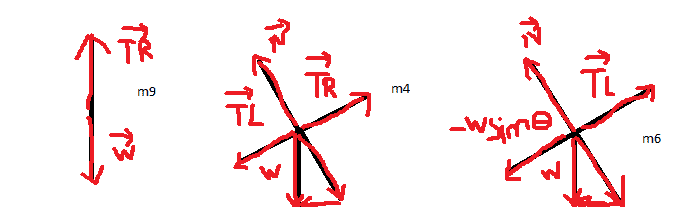

What is the acceleration of this system?
F=ma
I tried the following:
Let blocks with mass 9kg, 4kg and 6kg be m9, m4, m6
This is the free body diagrams I drawn:
Three free-body diagrams labelled m9, m4 and m6, with red arrows for tension TR, TL, weight w and normal force, drawn on blocks on inclined and vertical surfaces.
Then I applied Newton's 2nd Law:
F = ma
(For m9) mg-TR=9a
(For m4) TR-TL=4a
(For m6) TL-w*sin(30)=6a
I solved for a and it didn't gave the right answer.
What I am doing wrong?
duplaimp said:
(For m9) mg-TR=9a
Good.
(For m4) TR-TL=4a
What about gravity?
Good.
Gravity applies to m4 just like it does to m6.
I didn't included that because as m4 is "in the middle" I thought it wasn't necessary but it seems I was wrong. Now it gives the right acceleration.
Thank you! :biggrin:
