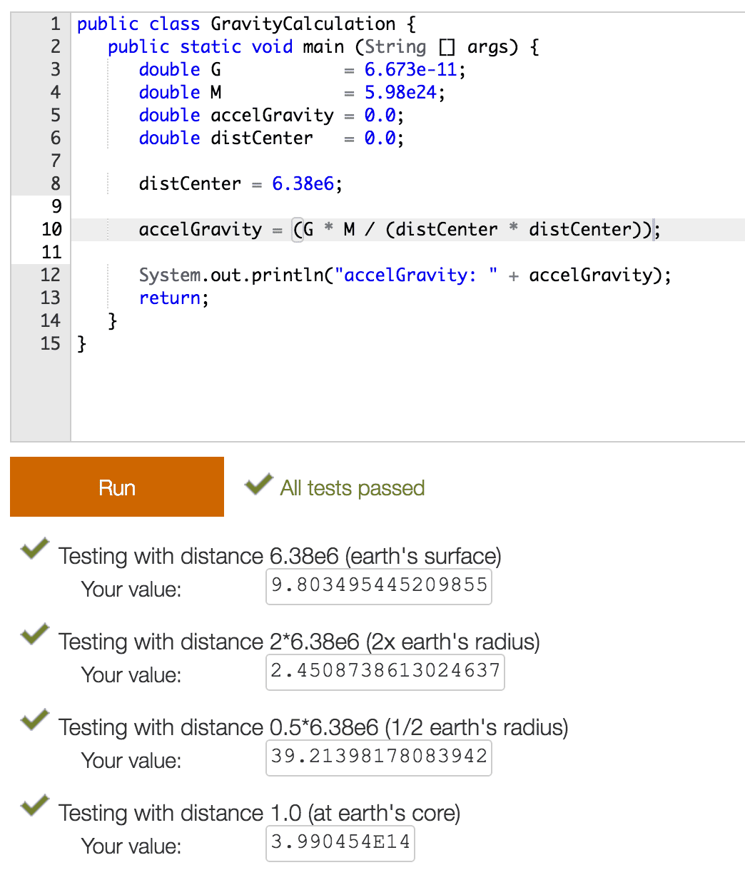

The answer has to compute to 9.803495445209855 however, I'm getting the answer 3.990454E14
This is how I inputted the code, did I format it wrong?

Hi obeying! Welcome to MHB! ;)
If we read [M](G * M / distCenter * distCenter)[/M] from left to right, as equal priority operations are supposed to be applied, we get [M]((G * M / distCenter) * distCenter)[/M], which is actually equal to [M](G * M)[/M]...

Okay, so I set it up wrong all together?
We just need parentheses: [M]G * M / (distCenter * distCenter)[/M].

It worked! Thank you so much, I can't believe I was that close to getting it.
