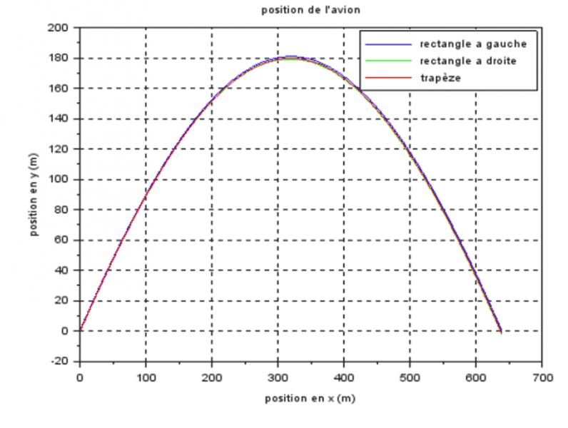

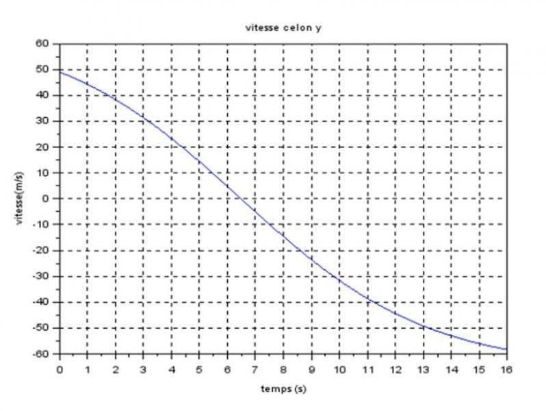

Here are some samples we had from our theoretical analysis.
-velocity on z axis (up)
-path : x=f(z)

The velocity/time-diagram does not show a microgravity environment.
mfb said:
That's what your accelerometer will read. The real airplane will still accelerate downwards.
