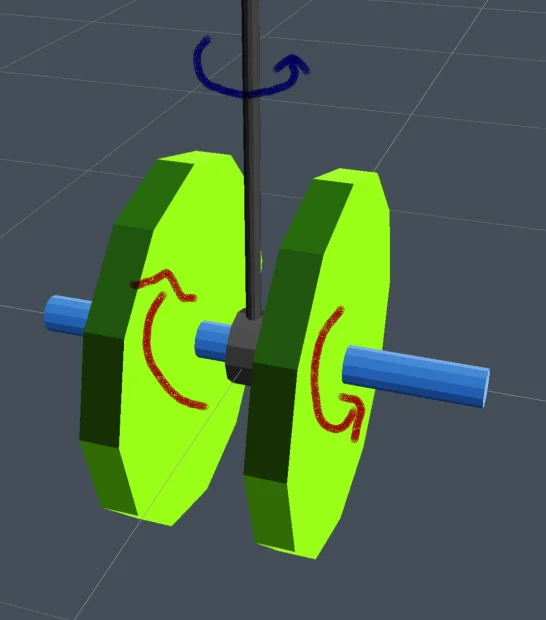

If you wish to test this more simply than i did, bolt two angle grinders back to back using a reasonable length of threaded bar with the heaviest discs you can find. When you try and turn them when running you will feel the resistance to rotation and hopefully see the deflection in the handles, using a less rigid shaft may assist in seeing this, or use two gyroscopic precession demonstration wheels, joined by a spring, hung centrally.
I think this is roughly the apparatus OP has in mind.
The two green discs are identical and counter-rotate about the blue axle with equal and opposite angular velocity (red arrows). OP can apply a torque to the dark grey suspension (blue arrow) to rotate the system in the horizontal plane.
I think that the analysis of this is that, ideally, there are no external forces here except the torque used to start the system rotating horizontally. However, there are internal forces when the system is rotating. The two green discs will attempt to precess in opposite directions, leading to no net force on the system but twisting forces between the discs and the blue axle. Ideally that doesn't matter, but in reality it will lead to increased friction in the bearings (and deformation of the axle if it isn't ideally rigid), which will brake the discs. It'll probably also cause twisting forces on the dark grey mount, at least as transients when the torque is applied to the mount.
So an idealised analysis shows no net forces in any case, but in a more realistic analysis there's very likely more friction when the system is rotating in the horizontal plane. So the system will brake faster when it is rotating, and careful calorimetry would find the "missing" energy dissipated as heat and vibration.

Sorry i didnt get to post the set up yesterday. Thank you, that is the system.
OK, and where is energy "destroyed" here (aside of dissipation by friction)?

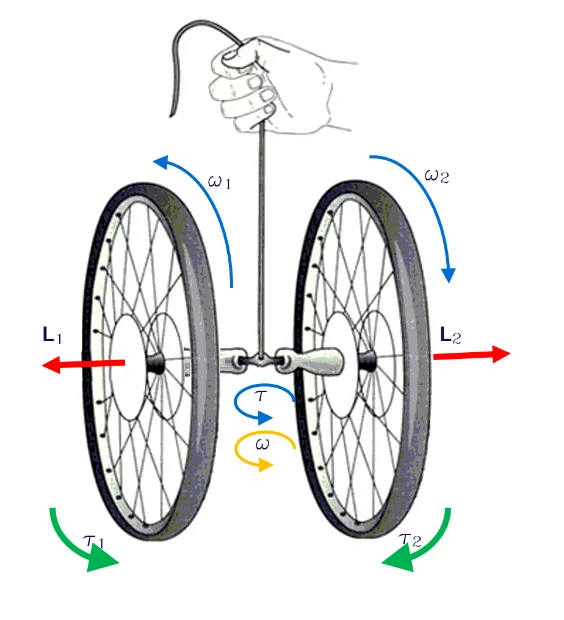

Not sure if I’ve represented the resulting torques correctly, you apply a torque to create angular rotation omega, the change in angular momentum directions create opposing torques restrained by the shaft thickness, at steady state there is no motion in the direction of the resulting torques. So you have torque and rotation in, but no rotation out in the direction of the resulting torques. Torque in is the sum of the resulting torques magnitudes.
That's not a prototype. That's a diagram.
What is "steady state", "no motion", and "resulting torques"? Since you have posted a labeled diagram, why don't you use those symbols in your text?
Can you write down the formulas for energy input, energy output and stored energy using the symbols you have defined? Where is the maths that you already have had checked by someone?
Also, what does actually happen in your experiment? And how did you ensure that the two wheels have exactly equal but opposite angular momentum?
