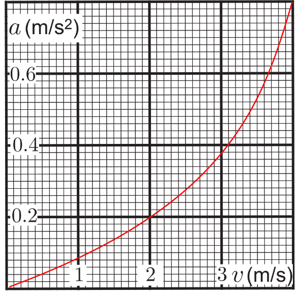

How can we find distance traveled from an acceleration vs velocity graph??
can we take small finite values and then limit them or it has something to do with derivatives?
for example take a look on this graph

It is done here, so it is definitively possible. If the acceleration is a simple function of velocity, it can also be easily done analytically, knowing that ##v=\frac{\partial x}{\partial t}##, ##a=\frac{\partial v}{\partial t}## and ##a = f(v)##, where the distance traveled is ##\Delta x = \int \partial x = g(v)##.
If you assume that the acceleration is constant, then it is a special case for ##f(v)## where ##f(v) = (0)v + constant##. Try to find ##g(v)## for that case and you should recognize a familiar equation of kinematics.

assumed a/v = constant(c) thus, dv/dx = c so dx= dv/c therefore distance = area under v/c graph.

Why doesn't the following work in general for a function a(v):
[tex] \ddot x = a(v) = a( \dot x)[/tex] [tex] \ddot x = \frac {d \dot x}{dt} = \frac {d \dot x}{dx} \frac{dx}{dt} = \dot x \frac{d \dot x}{dx}[/tex] [tex] \dot x \frac{d \dot x}{dx} = a(\dot x)[/tex] [tex]\int \frac {\dot x}{a(\dot x)} d \dot x = \int dx[/tex] [tex]x = \int \frac {v}{a(v)} dv [/tex]
Of course, you need to know where the function starts and ends, so if the function re-traces itself you need to break it up into pieces, but if you know the path this should work in general.

Since the acceleration is never negative, the velocity increases monotonically. It follows that time also progresses left to right in the graph, and acceleration increases monotonically.
That said, the method is still not trivial. One has to draw a second graph by plotting v/a against v and find the area under that.

well you are absolutely a/v can not be a constant we must find a(v) it can be found by tracing the curve but I am unaware of how I checked out on google but can't get it maybe interpolation can be used.
This is why you can also use the more crude approach (as done in the link I provided in post #5):
$$\Delta x = \sum \frac{\bar{v}}{\bar{a}} \Delta v$$
Where ##\bar{v}## and ##\bar{a}## are the average velocity & acceleration during interval ##\Delta v## (which you arbitrarily define).
This method is related to the Midpoint Rectangular Approximation Method shown here.

Here is the text of the problem:
The acceleration of a boat depends on its speed as shown in graph. The boat is given initial speed v0 = 4m/s. What is the total distance traveled until the boat will almost come to rest?
As you can see, there was some critical information that was missing, and because of that people - especially those who tried to solve the problem for the OP - made some incorrect assumptions and jumped to conclusions.
Furthermore, there is about half a page of text following the problem describing how to solve it. I can't see any good reason why the OP didn't mention any of this either.

sorry for inconvenience I am new , will take care of this next time whenever I post any question I apologize for such an ignorant and foolish behavior from my side, I only ask for an apology no explanation in defense.
Moving forward, I solved the problem thankyou to all the helpers for guiding and I appreciate their efforts for correcting me whenever I was wrong.
