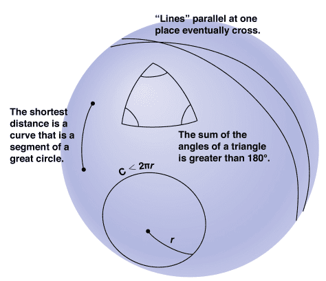

If you draw a triangle on the surface of the Earth you will find that the sum of the angles is greater than 180. This indicates that the surface of the Earth has positive curvature. It is measurably not flat.

As others have mentioned, the spatial geometry of the Earth's surface is not a flat spatial geometry. A flat spatial geometry would satisfy Euclid's axioms, and there is a proof that the sum of the angles of a triangle on a Euclidean plane is always 180 degrees.
See for instance http://www.apronus.com/geometry/triangle.htm, or a textbook if you want a quality reference.
Geodesics on the surface of the Earth are great circles. Sometimes they are informally called "straight lines, but geodesics is a more precise term. A simple field that studies the geometry of the Earth is spherical trignometry, if we ignoree the fact that the Earth isn't quite spherical. It's useful for talking a bit about curvature in a way that is hopefully familiar and is easy to visualize and (cmopared to GR) relatively non-abstract.
We can draw triangles on a sphere, with geodesics forming the sides of the triangle. The sum of the angles of the traingle is always greater than 180 degrees, though it approaches 180 degrees for small triangles. You can look up more on this in spherical trignometry, but a simple example of a triangle on the surface of the Earth whose angles sum to 270 degrees (3*90) would be a spherical triangle formed by starting at the north pole, going south to the equator, making 1/4 a circuit around the equator, and then going back to the north pole.By this example, and others, we can therefore conclude and confirm that the Earth's surface is not a plane because it doesn't satisfy Euclid's axioms. We can even tell which axiom it doesn't follow - it doesn't follow the parallel postulate. Some posters have already mentioned that we replace the parallel postulate with "parallel transport", but learning how this works gets rather deep into Riemannian geometry.
There is a lot more to understanding curvature, but understanding the terminology well enough to know that the surface of the Earth is not flat is a good place to start. I'm not quite sure why you think it's flat, I hope I have convinced you that it can't be.

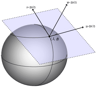

Sorry, you lost me, and I strongly suspect you are using highly personal (and not generally accepted) defnitions of many important terms, such as "tangent", and curved.
To take such a simple case, let's talk about a tangent plane to a sphere. You seem to be thinking that the tangent plane touches the sphere at more than one point, when it doesn't do that, and the actual definition of a tangent space defines a different tangent space for every point on a manifold. In this context the surface of the Earth is a stand-in for the more abstract concept of a manifold.I don't wish to be impolite, but you're way, way, offtrack, and you seem to be more interested in pushing your own highly personal views than learning anything :(.
By your definition, every smooth surface would be "flat" no matter how many wiggles and warps it had. There are always geodesics on a surface. So that is not a useful definition of "flat". The useful (and correct) definition of "flat" is that the usual geometry of triangles and circles applies -- the sum of the angles of a triangle is 180° and the circumference of a circle is π times the diameter. The surface of the Earth is not flat.
