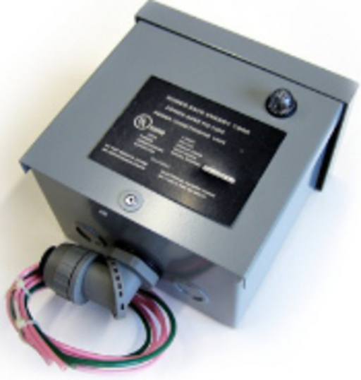

Here is a picture of the product
Apparently it requires a separate 20A dedicated circuit. (Another cost sink.)
It is apparently only a bank of capacitors. (I do see a pilot light. I wonder if that constant energy cost eats up any possible marginal savings.)
I see prices between $250 to $315. (There goes the economic stimulus check.)
