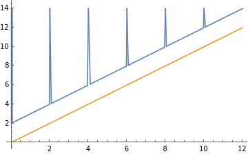

Plotting Arg[ f[x] ] gives output that has jumps of +/- 2Pi and is limited to +-Pi.
Can we unwrap this into a jumpless plot?
This discussion https://community.wolfram.com/groups/-/m/t/1340126 includes some ideas to unwrap a list of wrapped-around values such as phase (e.g. Arg[ f[N] ] ). You can use this to ListPlot a jump-free graph.
I'm trying to adapt this to work in Plot rather than ListPlot. The idea is to plot fnUnwrap [ myPhase[t] ], where fnUnwrap is called whenever the plotter wants to evaluate the Y value.
Now fnUnwrap needs to use two successive phase values, and also maintain a cumulative total of all the jumps. So we store some "state information" in the variables unwrap`old and unwrap`cumu, i.e. the previous input and the accumulated jumps. Here is my attempt:

This code "sort of" works, but has these spikes around the jump points and has an offset as well:
Code:
unwrap`old=0
unwrap`cumu=0
Plot[{ fnUnwrap2[Mod[ x, 2],2,1.75],
           x
    },{x,0,12},PlotRange->All,PlotPoints->250]
Output:
Line plot of two lines against x from 0 to 12: an orange straight line rising from 0 to about 12, and a blue sawtooth-like line rising from 2 with vertical spikes up to 14 at x = 2, 4, 6, 8 and 10.
Can this be fixed , or is there a better approach?
Perhaps part of the problem is that the plotting algorithm often evaluates Arg[f[x]] in a random sequence of X. Maybe we need to store not only old_Arg but also old_X, and somehow use that to avoid confusing the plotting algorithm.
Any suggestions much appreciated.
