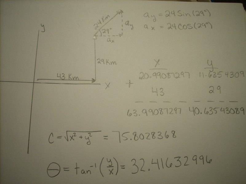

A car is driven east for a distance of 43 km, then north for 29 km, and then in a direction 29° east of north for 24 km. Determine (a) the magnitude (in km) of the car's total displacement from its starting point and (b) the angle (from east) of the car's total displacement measured from its starting direction.
I do not know where I am going wrong, but I cannot get the answer no matter what I do.
I have attached a picture of the problem as I have worked it out.
For part (a) I have 75.8028368 km
for part (b) I have 32.4163299 degrees north of east
I am allowed a -/+7% tolerance.
  • Handwritten vector work: x-y axes with a 43 km east vector and 29 km north vector, a 24 km vector at 29 degrees from north with components ay = 24 sin(29°) and ax = 24 cos(29°), component sums, magnitude C = sqrt(x² + y²) = 75.8028368 and angle θ = tan⁻¹(y/x) = 32.41632996.
The answers are
(a) 74.054828934557 km
(b) 42.458201635351 ° north of east
I was fairly close on the magnitude, but I do not know why I am not getting the angle.
