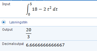

Hello PF,
I need some help with the assignment given:
v=18-2t^2 m/s, where t is in second. When t= 0 the position of the particle is s_0 = - 3 m.
For the first 5 seconds.
Determine the total distance ( i got it to 65,33 ft) and the net displacement Δs, and the value of s at the end of the interval.
I guess I have to use the formula:
s(t)=s_0 + ∫_0 ^t v(t) dt
s(t)=3+∫_0^3 18-2t^2 dt

cnh1995 said:
That is the correct equation.
S0= -3m.
But when I integrate it, I do not get the correct answer.
Why are you multiplying the integral by -3?
Also, the upper limit of the integral is not 3.
gneill said:
... and tf = 5 seconds.
May bad. So this should be correct?
That number is relevant. Which part did you answer with it?
